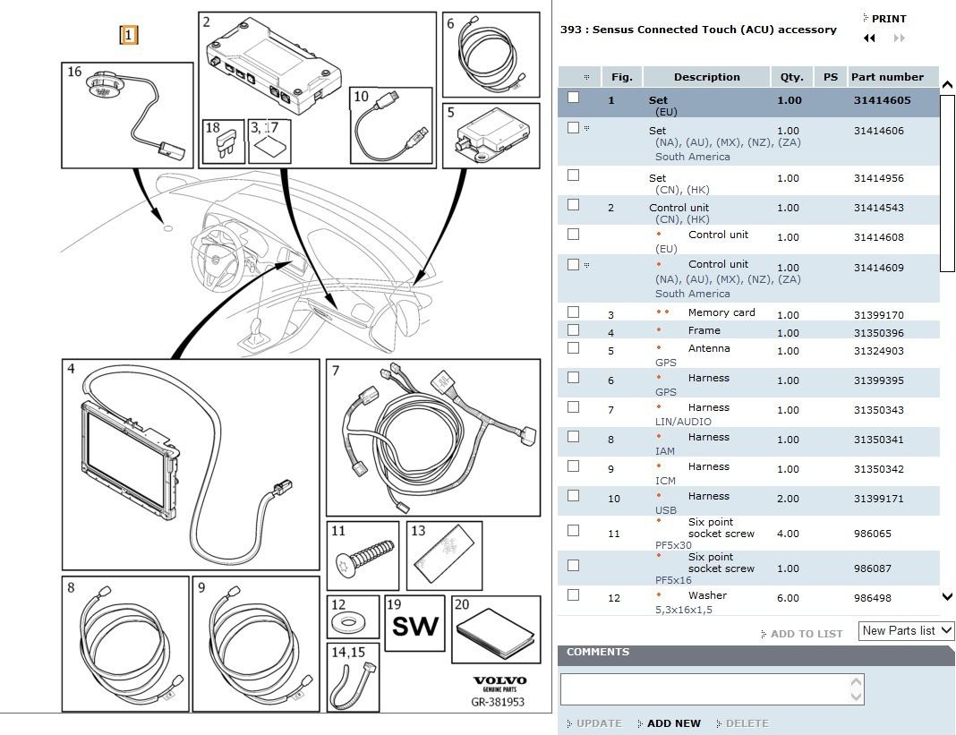

Old Mar 23, 2021 | 08:10 PM
Originally Posted by natsea
Is there an after-market touchscreen "infotainment" system that can replace the OEM display
Volvo offered that as an accessory to replace your existing screen - the 31414606 kit is unfortunately no longer available - I fixed that by purchasing a newer car (a 2020 xc60) and live with the non- touch screen on my 2015 xc70. I don't imagine anybody designing an interface that would do everything the screen you have does. At least for a reasonable price, there's just not that many cars/people wanting that. You might be able to find a dealer somewhere that has that part - but it might cost at least a couple of thousand dollars to make it work in your car.
