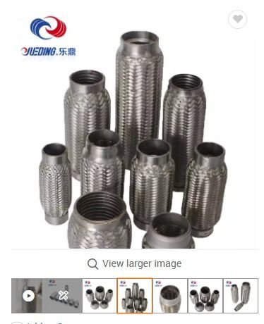

Your flex pipe might be leaking and causing the noise. Yes it is part of the " catalytic converter" in that it is welded in as part of that part. - But if you find the right person/shop - (any dedicated exhaust shops in your part of the world?) the flex pipe can be replaced by itself, by cutting out the old one and welding the new one in place. Sample Flex pipe and sample cheopo aftermarket complete converter showing where the flex pipe is pictured below - Or you can purchase a factory converter for $1200 -$1600.
