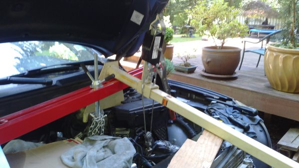

Default Dropping 2005 XC90 Transmission project
So after struggling with my local Volvo dealer to see if they would cover my transmission, they said NO. Since it has a REBUILT title, they will not cover the repair and quoted me something like $5K . Screw that! Lets see what I can do .
So it took a few months of researching and collecting some tools. I started to take on the task of dropping the transmission out myself. After a few days of free time after work, I was finally able to drop the lower sub frame. I secured the engine on top using an engine brace from Harbor Freight Tools. In the next few days, I will remove a few other parts (angle drive...) to get to the transmission. I will take more pictures along the way to share!
Feel free to ask questions and of course, please give me any tips or advice to consider along the way. I am learning as I go so bear with me.

I took some time off but was finally able to drop the transmission last week. Here are the pictures of the transmission being dropped slowly from below. Now I will bring it into the shop to have them split it apart and tell me what happened and to rebuild it again.
Attached Thumbnails 2005 XC90 T6 - Shuddering and clunking noise during acceleration-2013-07-06-15.25.04.jpg   2005 XC90 T6 - Shuddering and clunking noise during acceleration-2013-07-06-15.25.34.jpg   2005 XC90 T6 - Shuddering and clunking noise during acceleration-2013-07-06-15.25.20.jpg   2005 XC90 T6 - Shuddering and clunking noise during acceleration-2013-07-06-15.55.44.jpg   2005 XC90 T6 - Shuddering and clunking noise during acceleration-2013-07-06-16.35.45.jpg

I don't even like replacing those on a lift, I couldn't imagine doing it on jack stands!
When going together, be sure the passenger axle goes in perfectly straight. It's very easy to damage the seals in the chain gear. Take a look inside it now to make sure they aren't already damaged. Much better to replace the seals now than to have to pull it out again.
My first time dropping a transmission so i don't know any better , but the jack stands and some good tools made the process not so bad. Oh yes, the inner seal was busted up when I pulled out the passenger side axle, so that angle gear is being rebuilt also. Thanks for the tip in putting the axle back in straight.
