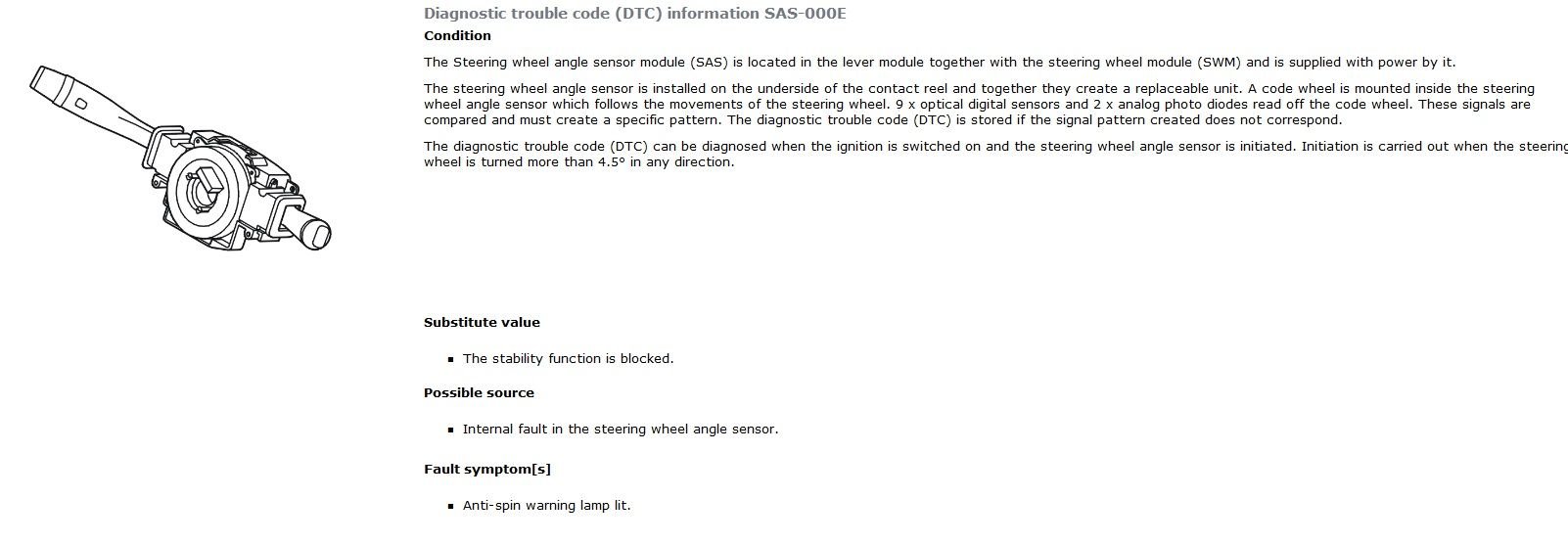

EDIT: Found this video of someone using VIDA to calibrate SAS in the brake/abs section
Here it is in the advanced BCM section
