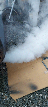

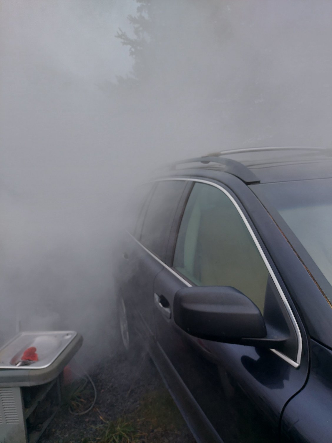

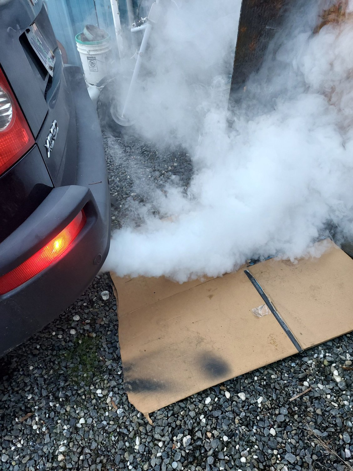

Well guys, Once again thanks for your responses. I just got back from my friends shop where the Volvo is and I'm just now reading your responses. (the rural area where the shop is located doesn't get internet or phone reception very well) and Y'all nailed it right on the head. The VVT solenoids have been leaking for who knows how long, they needed new gaskets but they were not stuck. And [hoonk]- your story is right on the money. This all started with a check engine light low oil pressure and an oil change- Discovered the PCV system was severely clogged- Fixed all that and related problems- Thought I was done and had it fixed everything- And then the F***ING turbo goes **** up?! (Yes we came to the same conclusion). I thought to myself "MAN, if it wasn't for bad luck- I wouldn't have no luck at all! I mean what are the odds?! And then I came home and read you guys responses and your story makes perfect sense it wasn't bad luck its one more consequence of the clogged PCV system. At least now I know and I cant see light at the end of the tunnel. I'm going to try and upload some pics and maybe a quick vid of what I encountered. We'd never seen anything like it. Just to confirm what we all think.
So turbos...do they make a rebuild kit or something? I haven't checked yet but I'm sure a new one must cost a fortune! And I'm pretty sure its not the kind of thing you want to buy from the junk yard. Again, Thank You sooo much gentleman for your input! I hope someday to pay it forward. I'll let Y'all know how it goes.
This is what it started doing after it warmed up. this pic doesnt do it justice.

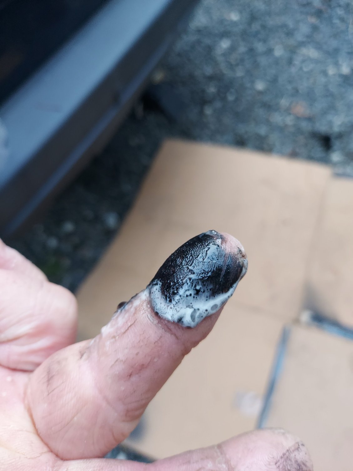

wiped my finger inside the tail pipe.
Old Feb 13, 2023 | 09:31 AM
With that much oil in the exhaust - It might take an hour of smoking to stop after a new turbo is installed!
