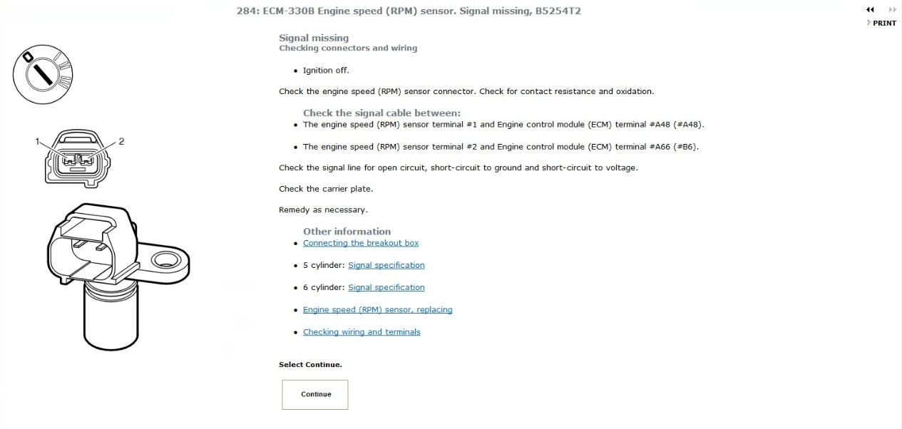

Vida also gives possible causes and solutions for codes (that a normal scanner does not). For instance you have a ecm code 330b - volvo gives this information when you click on the code, with links in blue to other parts of the program (in this case specs, wiring, replacement procedures and other stuff) All that info helps you diagnose the problem not just guess and replace parts until it might be fixed. Vida will not tell you the CEM is bad - you eliminate all the other possibilities first before condemning a CEM. But given your car flooded and water intrusion is a known problem/CEM killer on some xc90s - you easily could be needing a replacement. Check xemodex.com - I've used them for hundreds of control units over the years with a 99.9% success rate. Be sure to find the updated service info to reseal the CEM cavity when it goes back together. That will not be in VIDA - for that info came out after 2014
