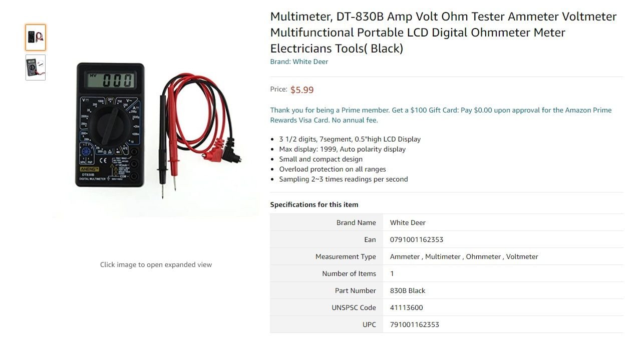

You need to fully charge the battery before trying to start the car. It's also possible the battery is damaged from being completely discharged. Older batteries don't like to be completely discharged. Do you have a simple volt ohm meter to test the battery voltage?

Yeah, I have a multi-meter. I didn'/t check the battery because I just assumed it was dead. Doesn't seem to matter to me how dead it is, but I can check.
First I've heard of "consumer gauge" jumper cables. Mine are pretty dang beefy. As for how I connected the cables to the neighbor's car, I hooked the hot cable to his battery terminal and the ground cable to a good chassis ground under his hood. I dd wonder if the reason it didn't work was because the battery might have been too far discharged and needed a bit of charge before it would work, but then I just figured that the XC90 was borrowing my neighbor's car's charging system and it shouldn't matter.
I'll check the battery with my multi-meter and maybe I can go ask my neighbor if he'd be willing to give us another jump. I have a trickle charger, but I don't know where it is. We recently moved and almost everything is still in boxes. It's in a box, I just don't know which one and I have hundreds to choose from. <sigh> Even though it's just a trickle charger it'll usually put a sufficient charge on a battery if left on overnight. Maybe I should just buy another one. Maybe one with more juice to it. I've had this one for over 30 years.

Okay an update for you.. I checked the battery with my multi-meter, and I'll tell you what -- I've never seen a car battery as dead as this one was. 2.4 volts. Yow. Well, given we've owned the car fof over three years and this was the battery that came with it, I just decided to buy a new battery. Problem solved. The car started right up with the new battery. Back to normal. But I've learned my lesson -- never leave this car in neutral with the engine off and the key out.
