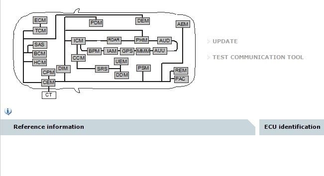

An basic OBD scanner just checks for emission related codes in the ECM and TCM (trans and engine control units). A compatible scanner will scan all the control units shown in the network diagram below if installed in your car - you probably don't have PHM - phone, or GPS or AEM (aux) . You'll only have a HCM if your headlamps turn with the steering wheel. So you have 15 to 20 control units that can store fault codes and be accessed for other information.
If you take it to the dealer and they think it needs a new UEM - that's about $1000 in dealer language. (a mirror replacement plus a VIDA download to make it work)
