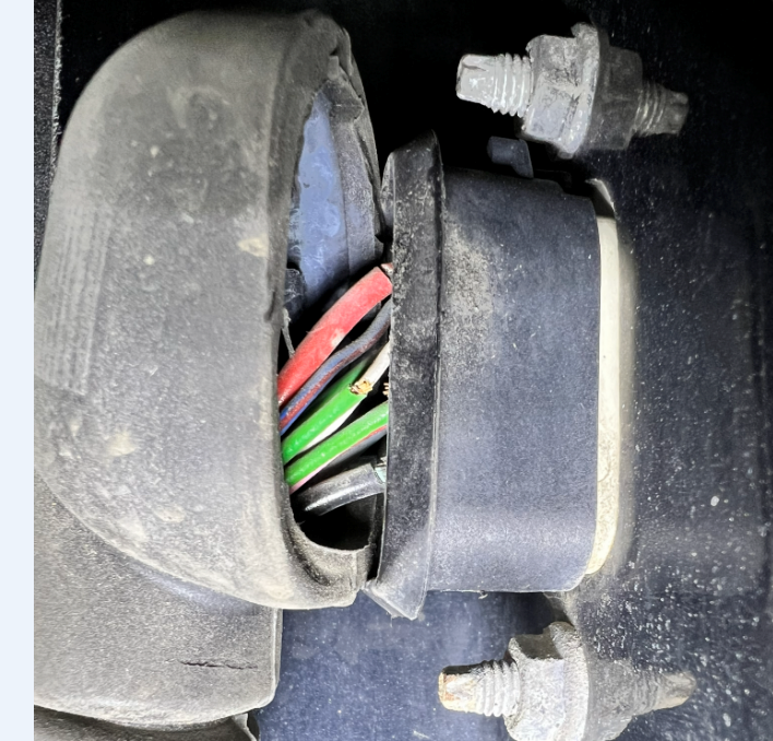

Hi all, one day, my right bulb indicator went out... figured it was the bulb, it was hyper flashing, etc...
So I replaced it. Nothing... replace the left side too... nothing, finally got a pen power tester and tested the socket, NO POWER when hazards are on... works OK on good side, I see the 12v. Not on the right side...
No Fuses blowned . Wire and socket look ok... no rust. or corrosion.
HELP any ideas... where does the green wire go to, I figure need to trace it... is it directly to CEM what pin? any info is greatly appreciated.
FOUND IT!
Does anyone have a how-to open and access this area so I can do a repair. My REAR indicator light stopped. Reason it seems like the door has the same green wire going to the rear.
When I put a tester pen on it... it flashes with 12V on/off... I presume this wire goes into the door for side mirror flasher then out to the back tail light with stopped working...
Any photos on how to remove or access this wire loom would be helpful... or open door panel
or is this a replacable part? if so how to?

FOUND IT!!!! : Does anyone have a how-to open and access this area so I can do a repair. My REAR indicator light stopped. Reason it seems like the door has the same green wire going to the rear.
