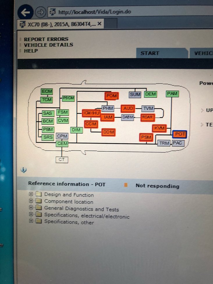

Your scanner may only read Emission related codes, those codes are stored are in the ECM (engine control module) and maybe the TCM (transmission control module). The picture is from VIDA, the factory service software - plugged into a 2015 - showing how the network is connected and all of the modules that can store codes - The CEM is the central electric module - the main brains of the car. When you turn the key - the CEM decides to whether or not to send a signal to the starter. The red and green are modules that this car has, the grey boxes are modules not available in this car - For instance the SUM module is for the 4c chassis, that's the electronic shocks - those are not installed in this car.

No, There are plenty of compatible scan tools that can talk to most modules on a Volvo -
But VIDA for your car is a free stolen/hacked download - you can find a download link in the OBD section of Swedespeed. You will need a interface, plugs into the obd port and a USB port on your Win7 Pro only CPU, called a DICE unit to be able to talk to the car - You can find clone DICE- on ebay/amazon for less than $100
It looks like this - that's one i just gave away - It would not talk to the modules on the low speed network - that's why they are all in red in the picture.
There's a guy on Swedespeed that sells VIDA on a bootable usb drive, presetup to work on many operating systems - just add a DICE unit.
