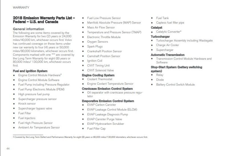

Old Dec 15, 2022 | 09:05 PM
I thought Emission warranties were for 8 year - X miles -
Have you sought a second opinion?
I did not read this article in detail -
https://jalopnik.com/advisor/volvo-warranty/

They told me sensors are considered consumables so are not covered under warranty. I think that's absolutely BS but I'm not sure what else to do.

Old Dec 16, 2022 | 10:05 AM
Sorry I was wrong - it's not on Volvos list of stuff that's covered after 4 years. What's the problem with the O2 sensor? What codes appear? O2 sensors have heaters in them - and the heaters do go bad. A rear sensor will have no effect on how the car runs. It simply reports if the catalytic converter is working properly.

Old Dec 16, 2022 | 11:54 AM
Here's what Volvo suggests could be the possible cause of those 2 codes
