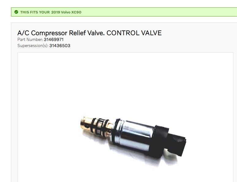

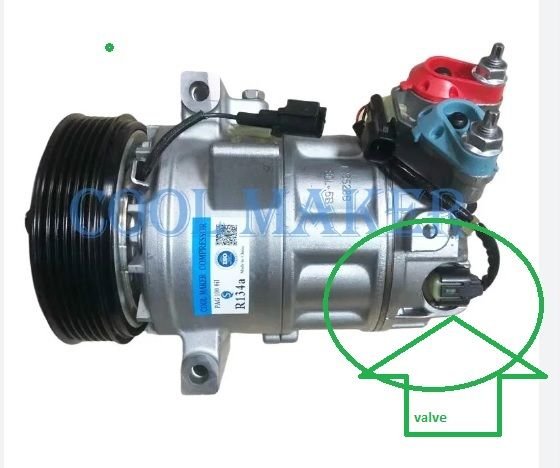

You have a variable displacement compressor. And your symptoms (low/high and high/low pressures) could be caused by a bad compressor valve. Many manufacturers use these valves to reduce the power the compressor needs to operate in some conditions.
I have replaced many bad compressor control valves in earlier Volvos to solve that problem - but have no experience with the new 4 cyl compressors.
Hopefully your "shop" knows of this mysterious variable compressor - if not you might want to find someone more knowledgeable. AND - try not to use refrigerant with any sealant in it - you may cause other problems with your car OR, the ac machine used to evacuate and recharge your system.
Google "volvo compressor valve" for sample pictures
This MIGHT be the correct control valve ---

Thanks for your knowledgeable response. I read about that valve been the culprit of the symptoms but didn’t know where was placed. I went to a Sweden mechanic shop but the guy was more like a Saab guy. I got an appointment with the Volvo dealership on Wednesday to get a 2nd opinion. Question, in order to replace that valve I need to vacuum the system first right?

The dealer will probably want to replace the compressor if they think the valve is causing a problem.
And yes the system needs to be evacuated (empty) to replace the valve. (and then recharged with the proper volume/weight of freon)
