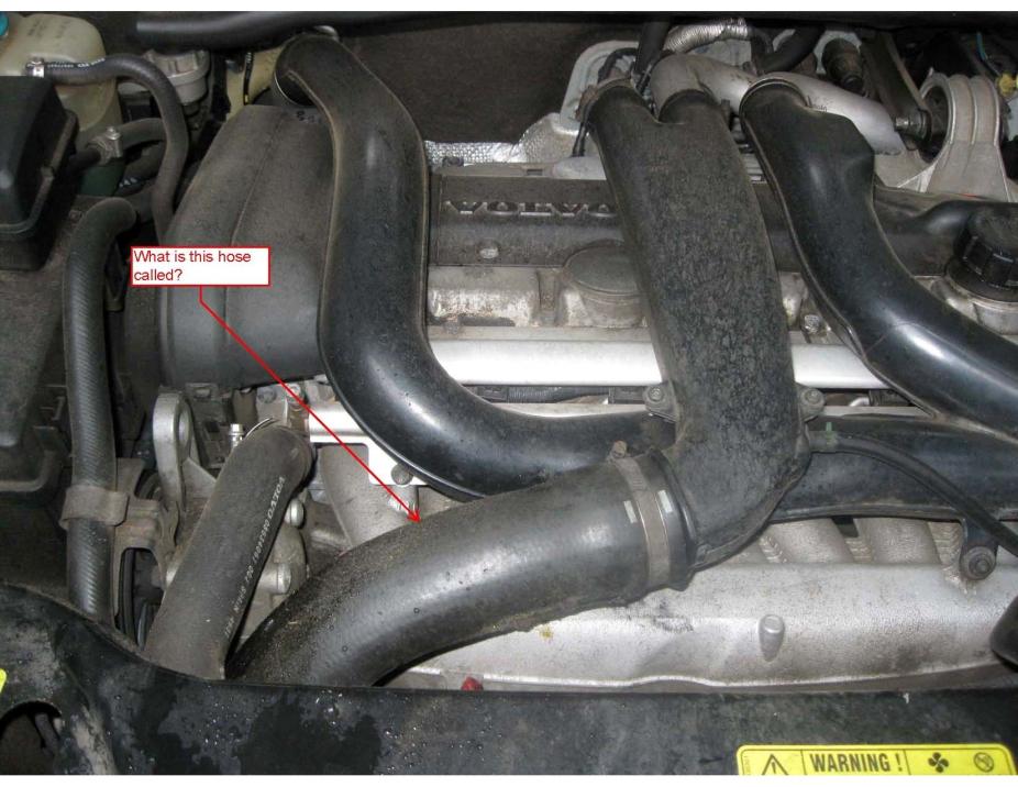

Can someone please identify this hose? It is really oil damaged. I think it goes from radiator to aftercooler? Can I get it aftermarket? will I need to drain radiator to replace? thanks in advance

That should be called the pre cooler hose. It is before the intercooler. It only has air going through it. You might be able to get it aftermarket but not sure.

You don't have to anything drastic like you mentioned to change it. Just 2 clamps, the bottom will be hard to get too though.

I was looking for "pre-cooler hose" online and found this "intercooler hose" that looks like my part. is this intercooler filled w/antifreeze?

No it's not.
