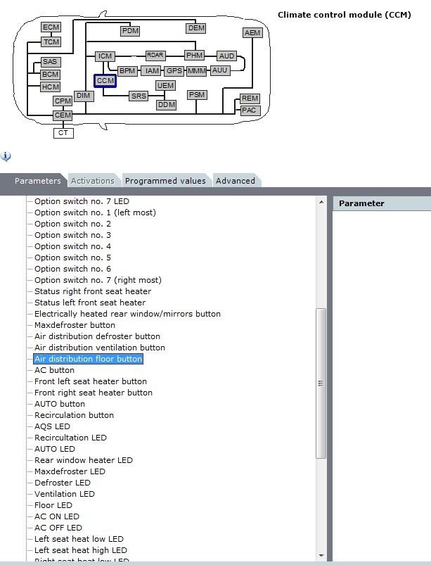

A good first step would be to scan all the control units in the car - especially the CCM. With the right scan tool you can also verify the CCM is responding to button positions. Or you might check fuse 10 on the CEM for the CCM. (wiring diagram is from a 2010 - you didn't specify a year)

Hi, firstly many thanks for the reply. Sorry I forgot to mention the model year, which is a 2010. I’ve checked all relevant fuses and everything is as it should be. I can adjust fan speed etc on the blower and I can hear the AC compressor kicking in so that’s ok. On the CCM all function buttons press on and off / light up, but I cannot hear the actuators for the air vents change position. I have a small Bluetooth OBDii connector in the car to link to my phone. Can you recommend any good scanning apps that may work with this car?
