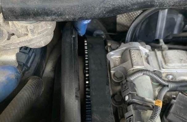

I did complete timing belt, water pump, serpentine belt 2 years ago and now have 160,000 miles on it. I did notice that the timing belt on the Exhaust VVT is on the edge so the cam gear may be worn out. Please see my picture below. I am going to remove the timing belt and see how much play it has.
