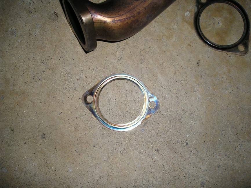

This is the gasket that goes on each side of the pipe that connects the exhaust manifold to the cat. 4 gaskets total. I realize the book says to replace them. But is it really necessary?
Attached Thumbnails can the intermed pipe gasket be reused?-intermed-gasket.jpg

You can reuse them if they are all in that condition.

Great. Thanks. No copper paste?

Nope. They go on dry.
