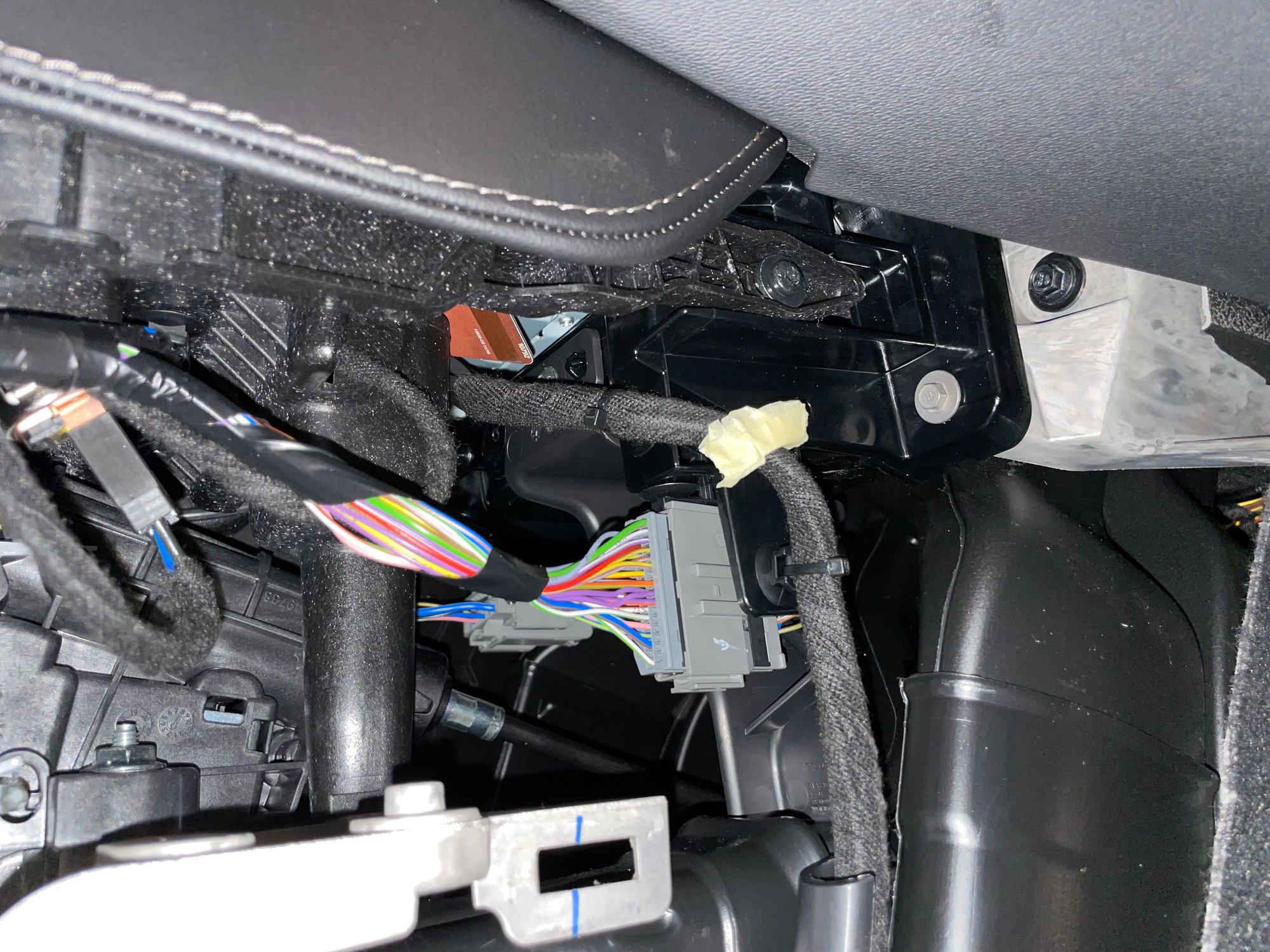

Default Access via passenger console cover
Pop off the fabric cover on the passenger. You can see my credit card (orange) in the picture
Cover removed. Just pull on the panel.
Now I'm curious, in the lower left of the bottom photo just left of center, there appears a shaft of some sort to turn 'SOMETHING'. What could that be??? Curious mind here LOL.
Old Sep 25, 2021 | 09:00 PM
ssicarman's Avatar
Posts: 285
Likes: 14
From: Western Canada
Below the wiring harnesses in the nicely framed opening?
That is the shifter cable.

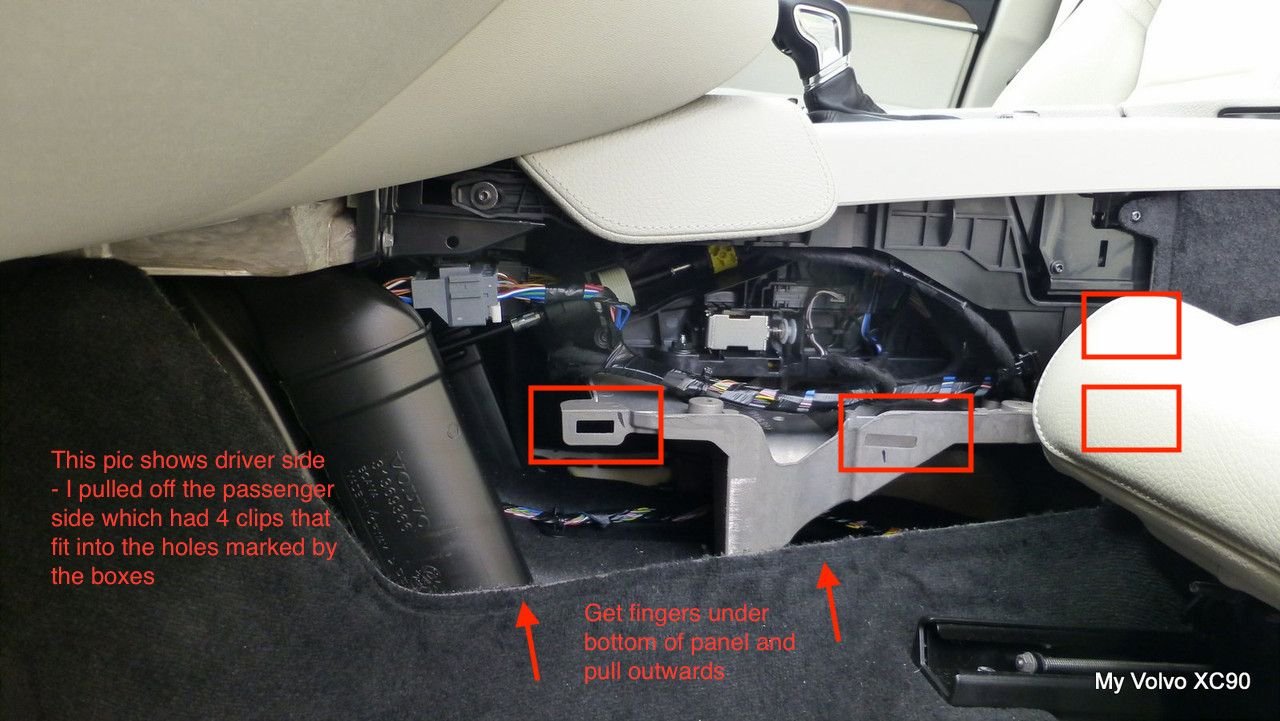

Could you give a little instruction on how to remove this panel? I don't want to break any fasteners when I pull mine off so that i can't get it back on again. Thanks!

Ok, I actually found another post on the UK forum. I used the pic they had posted but marked where the clips are. I should have taken my own pics. For anyone trying this, it was easy, and pretty easy to get the credit card out. Mine was in the same place as Driftless's orange card.
