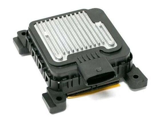

If you have the 5 cyl, 8 cyl or any engine with a fuel pressure sensor on the injector rail there is a fuel pump control unit. Yes the fuel pump fuse is #9 in the b fusebox but it's the PEM (4/83) that actually powers the pump (6/33). Some of those were mounted on the right side of the gas tank near the rr tire and were prone to corrosion. Later they were moved inside the car either in the trunk or under the seat to prevent corrosion failure. .Picture of controller attached.

I have the v-8. I checked for power at station 8 on the fuse block, and I do have power there. The PEM is located inside the car, on the right hand side near the fuel pump location, and does not exhibit any corrosion. I will check power continuity from the battery power post, but why a power disconnect would happen there coincidental to changing the fuel pump seems a real oddity. Would a failed PEM give the indications I have described above?

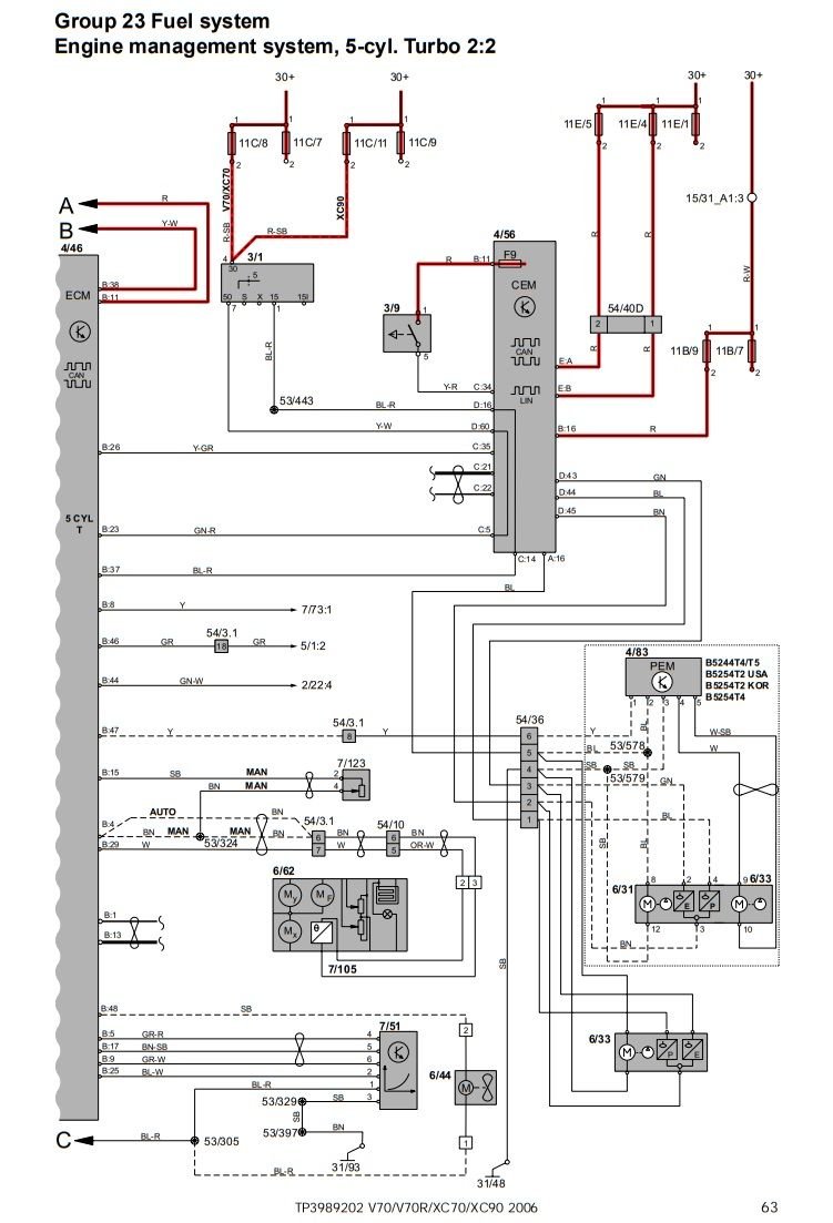

Here's the v8 diagram, very similar and less confusing.
