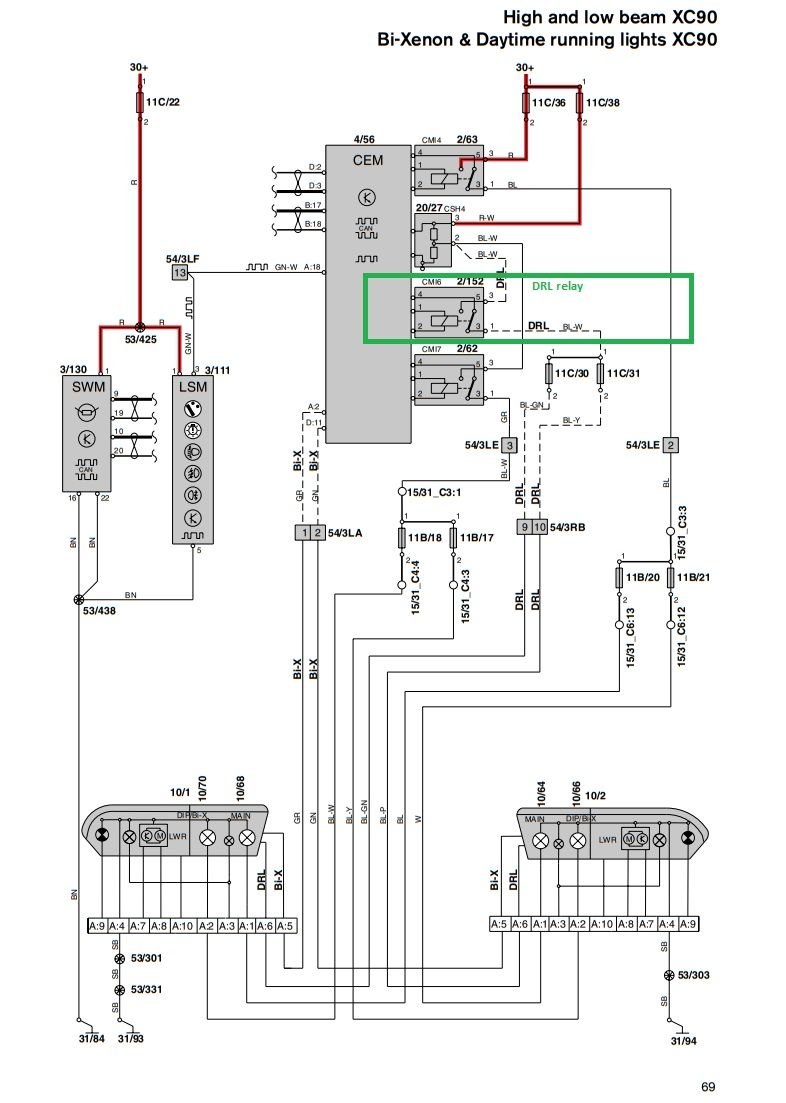

If you have HID bulbs - the inner bulbs are Daytime running lamps, not High beams. They are also the "flash to pass" lights. HID bulbs are not used (when off) to Flash - it takes too long for them to warm up.
So - Your front daytime running lamps are on all the time unless you remove fuses 30 and 31 - the rear daytime running lamps (rear parking lights) are not on, your turn signals don't work and you replaced the TS switch. Do your emergency flashers work?
This info is relevant for a 2004 - the OP had a 2006 with a different wiring scheme.
The TS switch plugs into the steering wheel module. The SWM takes all the signals from the steering wheel, converts them into a bus signal and sends that to the CEM. I would spend some time with a compatible scan tool investigating those signals. What codes are present in the CEM? Below is a description for one of the swm codes showing possible faults. Has someone installed a used SWM?

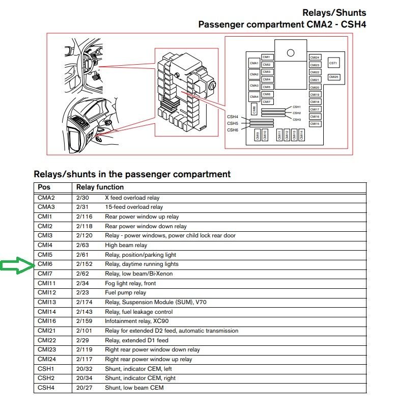

There is a relay on the CEM for the daytime running lights - but that won't solve your turn signal problem.

If you have HID bulbs in the outer headlamps, the Inner are Daytime running lamps. In the wiring diagram posted earlier - the wires going to the DRLs have DRL written above them.
If you flash the lights by pulling the turn signal sw back - yes it will turn the high beam indicator on.
