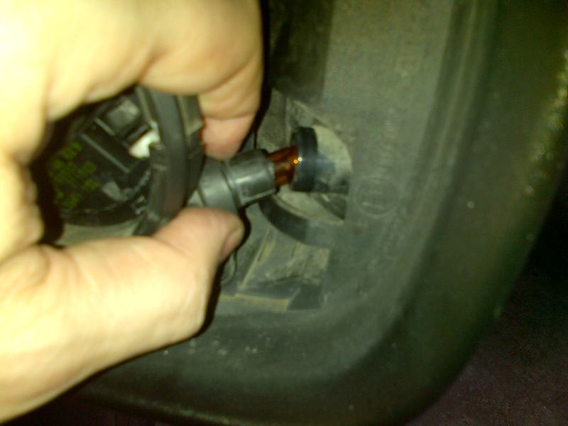

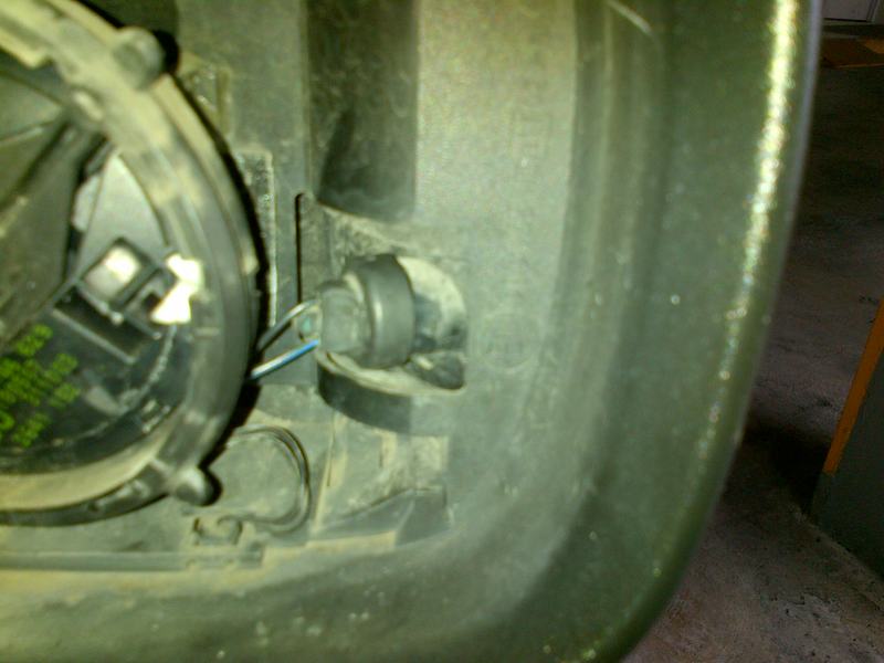

Hey Guys
Today I replace the blinker / turn signal bulb / lamp inside the side mirror.
You need to remove the mirror form the housing. In order to remove the mirror, you need to pry it out and then hinge it to one side.
As you can see in the pic, I use my fingers to pry it out. Be careful when you remove the mirror since it has it has 2 tiny wires that connect it to the defroster on the back of the mirror.
After you replace the bulb, to install again the mirror in their position, just pushed in their position and push it until you hear clicks.
Also, here is info that can help you too:
how to take off side mirror covers to replace turn signal bulb?
This is a piece of cake job
Hope this info and pics help.
THX
Isaac

Hello AAIIIC,
Does wires are the defroster for the mirrors. When you turn on the rear window defroster it also turn on the defrosters for the mirrors.
Is very easy to replace the mirror. Just follow my pics
Thx & Happy New Year
