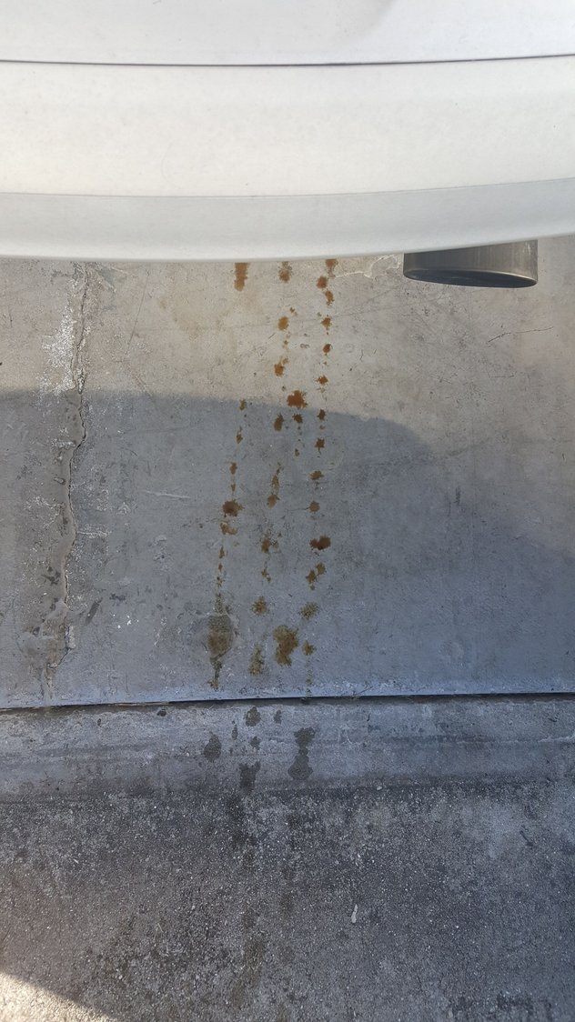

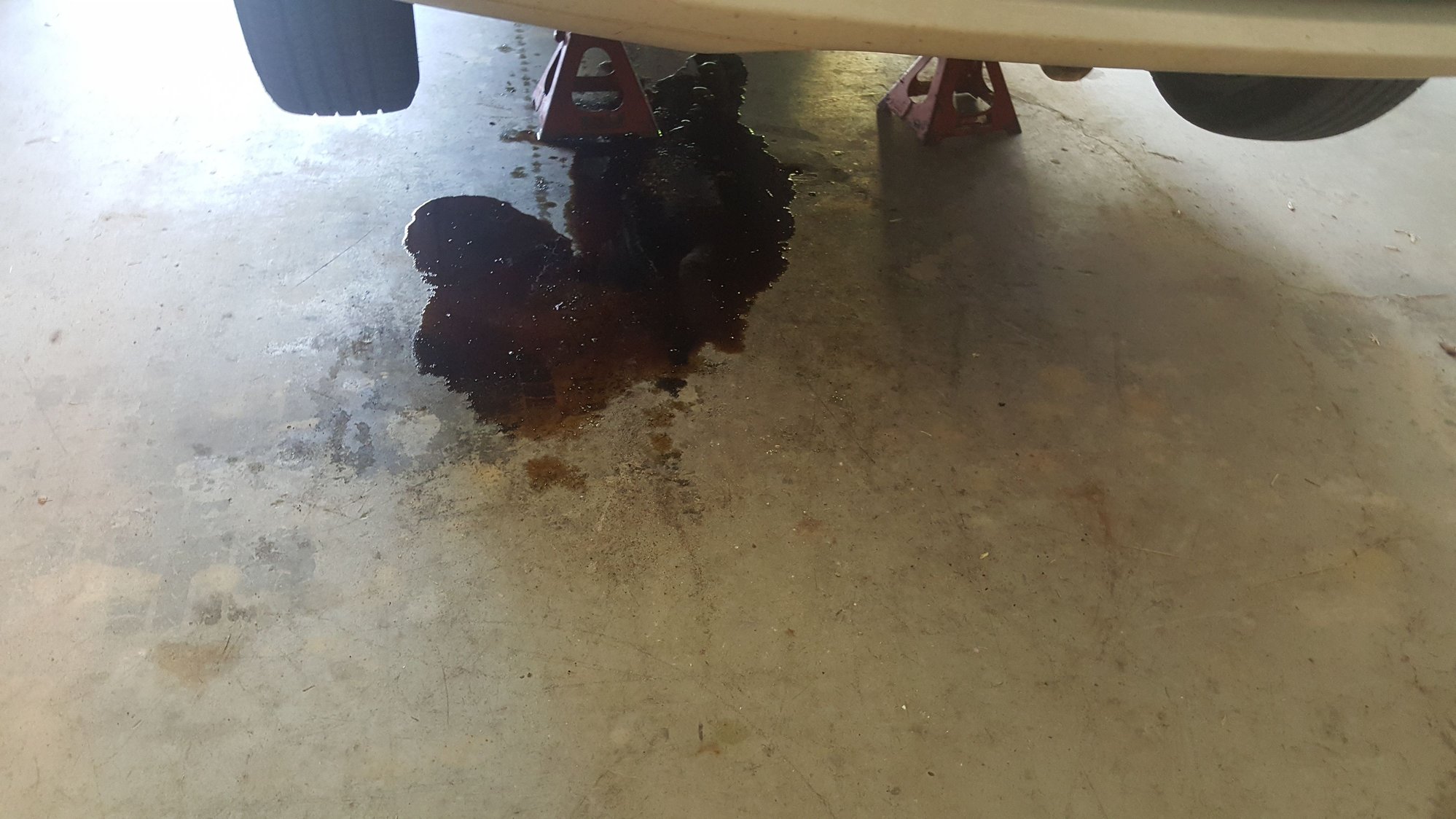

Afternoon update: Cleaned TB, no change. disco all air/fuel sensors, reconnect and fire up. Idle in park is 2K, right about 900 while in gear. Take her out for 2.5 mile test drive, seems to run okay, notice slight oil smell as I'm turning back into my neighborhood. Then we see this when we park her in garage:
Drippy!
Oh No!
I guess we'll be taking a closer look at that oil leak now!
FOUND!
Intake camshaft seal pushed out and there's the oil leak! From what I've read on this forum the PCV system on this model can get clogged and cause excessive pressure....so, ordering parts and we'll put her back together soon. Would have just thrown some sealant around the seal to prevent it pushing back out again if I didn't have to lockdown the cams to put her back together, doesn't look like that actual seal failed at all.

If you have a seal pushed out then you definitely have a clogged PCV system. It will also cause erratic running and idle since airflow is coming into the engine that does not go past the air mass meter (combustion backpressure).
