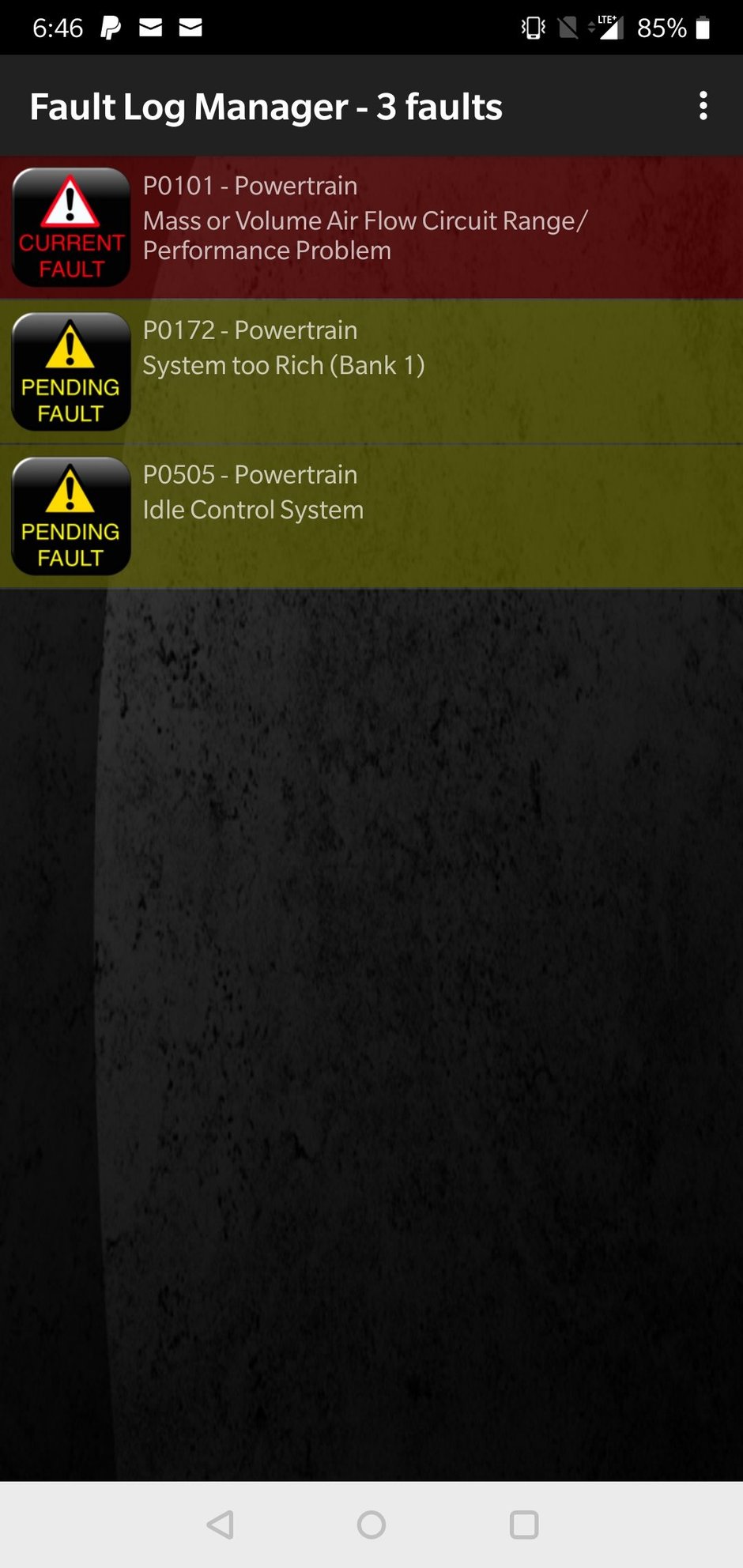

Hi everyone,
Can you please share your ideas on how much and how hard would it be to fix these fault codes?
Thank you!

Hard to say. The problems could be a host of things, including a bad catalytic converter or O2 sensor, MAF issues, any number of things that can cause misfires, etc.
Or it could be something simple like a single bad sensor or maybe an air leak on the intake beyond the MAF.
Since (I think) you're using the Torque app, see what the apparent temperature of the intake is reading, and see if it makes any sense. If not, you know you have a bad sensor or connection to the sensor. Fixing that might not (probably won't?) fix other things, but "everything is connected", so go for any low-hanging fruit you can find.

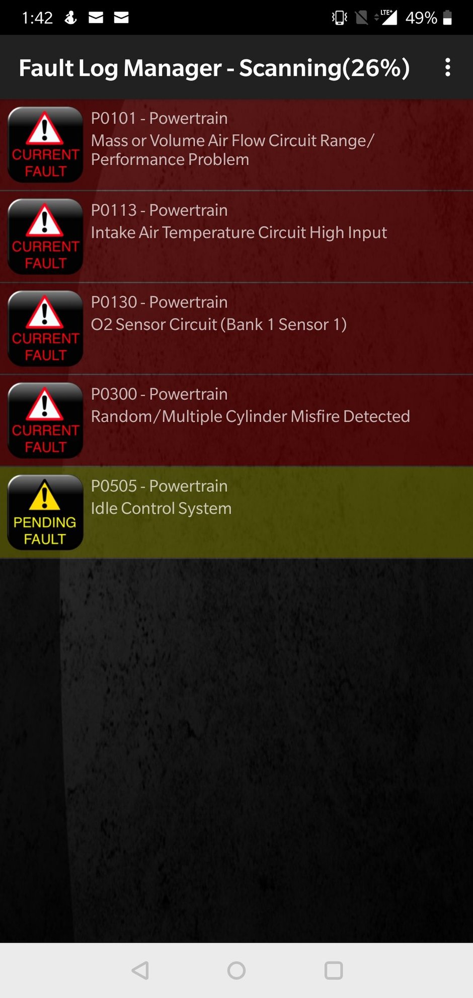

Thanks for the tip. I tried checking MAF sensor to see if it is working, the car keeps running even after I unplug the MAF harness from the sensor. Does that mean the sensor is faulty?
Also I checked the temperature reading in torque. Not sure what the normal range is supposed to be, but i have taken a screenshot of the reading. Would appreciate if you can take a look at it and let me know.

100°F is probably pretty normal if it's a warm day (the under-hood temperature is always hotter than the ambient temperature). That tells me that the intake air temperature sensor is probably working OK (not sure why it threw a code, but it could have been an intermittent problem).
My bet is still that there's a leak in the intake somewhere that's letting in air after the MAF (throwing off everything else downstream). But yes, cleaning the MAF is a great idea, and may well help (can't hurt!).

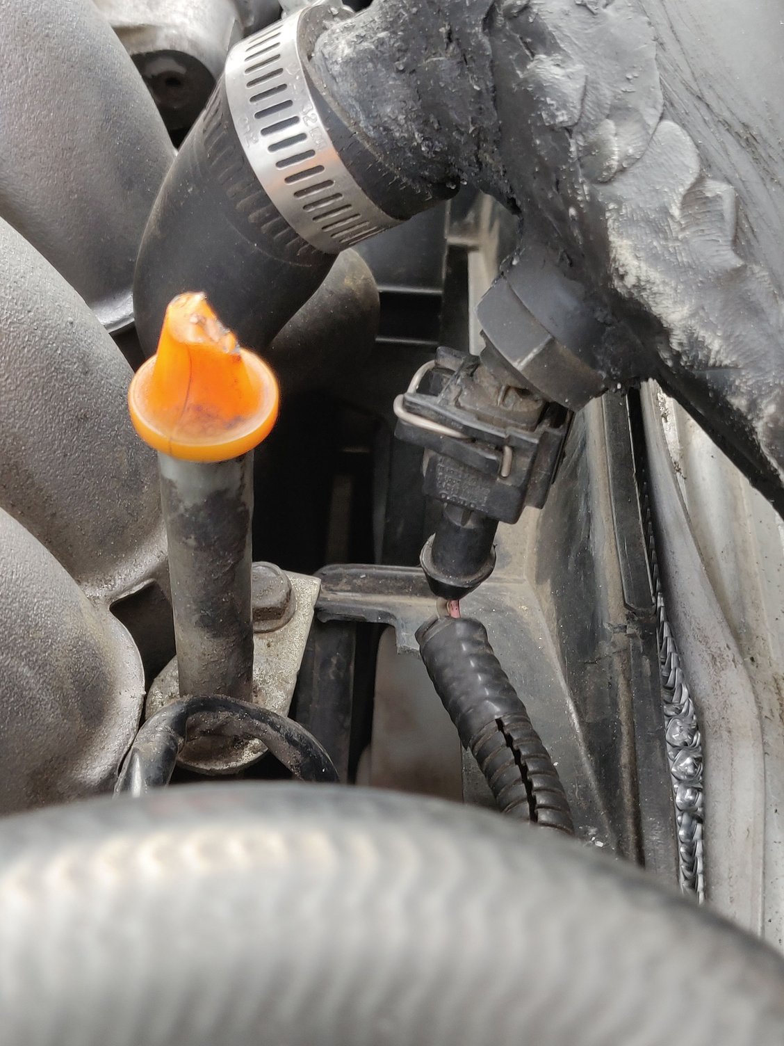

I found these two sensors, they might be broken. Do you know what they do?

The top sensor is probably fine. Looks like the looming has slipped off the plug body but the two wires look to be still firmly in place. I can't say as much for the rest of the radiator... that's one of the ugliest things I've ever seen. I wouldn't start across the street with it like that here in Arizona. You'll want to be pricing out a new one ASAP.
Your engine compartment is entirely different than mine though - I really don't want to guess what that bottom device is (can't really tell if it's broken, or just bent).
