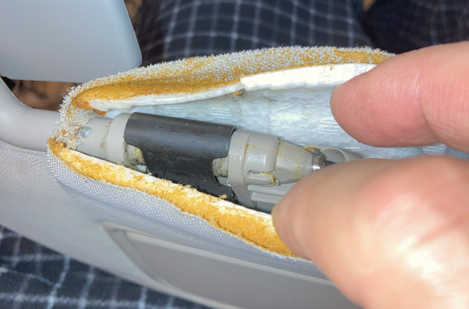

What breaks is a metal spring clip inside the visor. Ours was cracked along the bend of highest stress.
Cracked original spring clip from inside visor

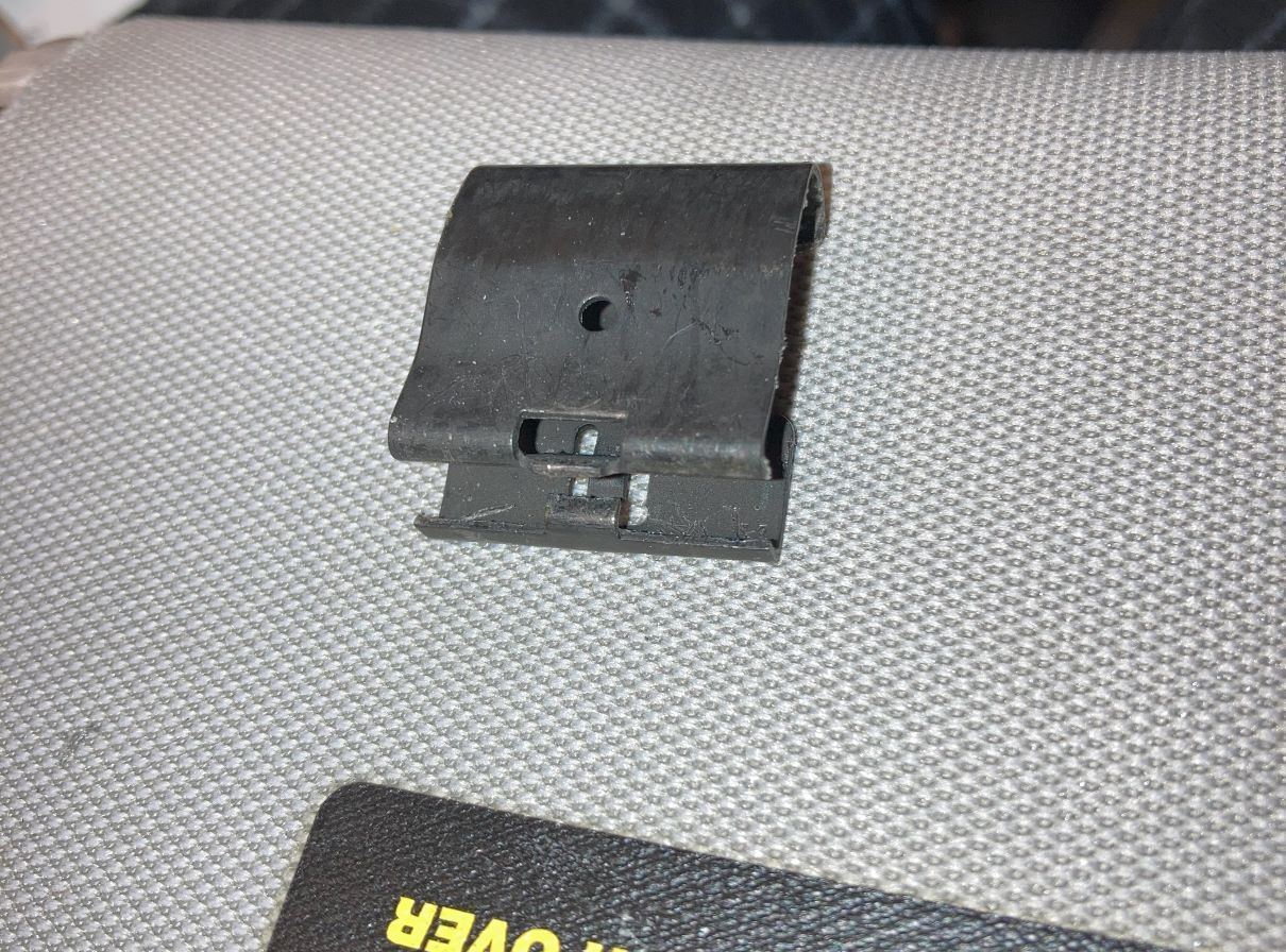

Replacement spring clip on it own

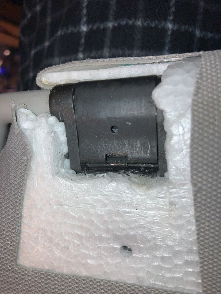

Replacement spring clip placed inside original visor

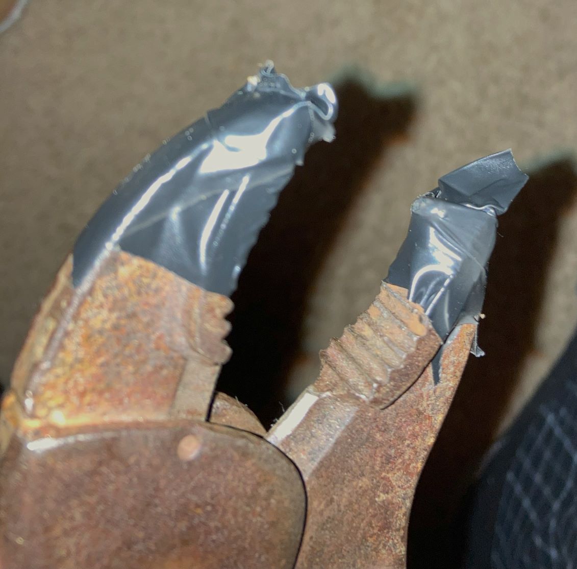

Screw 'teeth' taped at tips of pliers to close spring clip by pressing on it's clip side

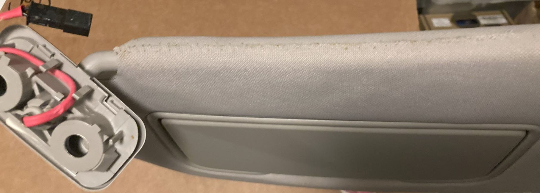

Finished, stitched up.
