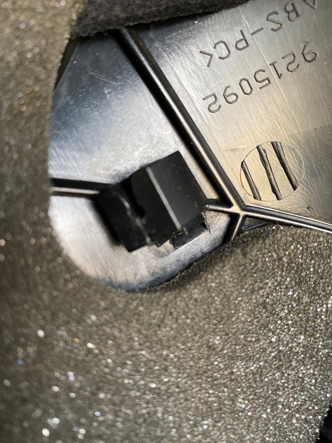

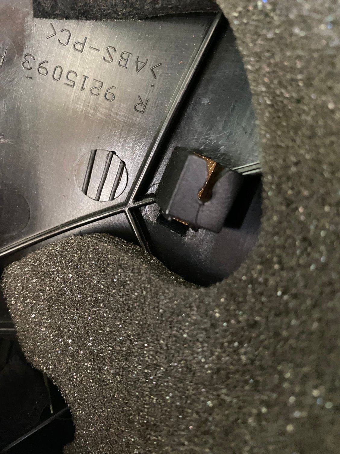

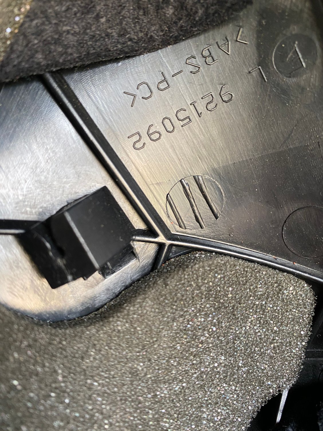

My passenger-side "C" pillar "flap" won't "pull in" when raising the roof. I bought this car about 6 months ago. I cycled the top and stopped it about half-way and was able to see that one of the mini bungee cords popped out of its anchor. I went over to the other side and discover the previous owner must have experienced the same thing. On the other side that is working, I noticed someone drilled a small hole in the plastic next to the anchor clip. If you do this, I'd be very careful about drilling through the headliner(!).
In any event, it was a small hole. They then used a small, black cable-tie (one of those that threads on itself and locks permanently in place). This went in the hole and through the clip, and locked the small metal anchor on the end of the mini bungee cord to the anchor. This is in there solidly now. I will do the same thing once if find a small cable tie (I would think the smallest size is more than enough).
Again, my only concern is drilling through the plastic backing without puncturing the headliner. Attached is a photo. The arrow point to the snipped-off cable tie.
cable-tie anchor for mini bungee cord

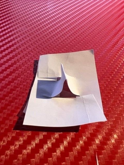

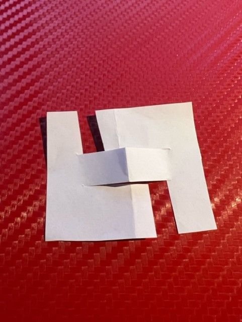

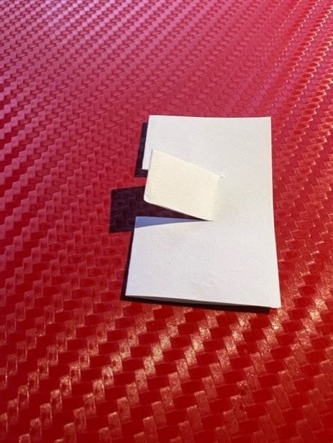

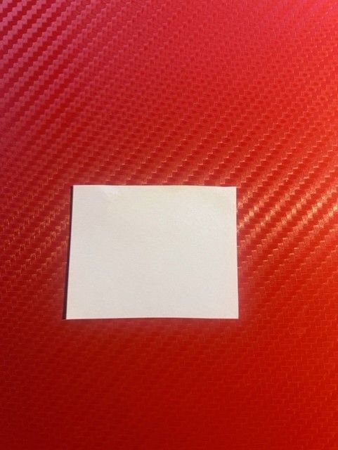

I had the same problem with these broken clips on both sides of my roof. I tried glues & epoxy, but nothing worked. I took a piece of soft leather and cut roughly a 1 1/2" square. I folding the leather square in half and then cut two parallel slits. I then cut the square so that I can form a tent. I glued the flaps in place. I then fed the leather pad through the back of the broken clip. The cord is passed through the tent. The leather patch is too big to be pulled through the back of the broken clip and the cord is able to slip through the tent freely as the roof opens and closes. I did this repair over a year ago and it has worked perfectly. I have attached a series of photos showing what I did, using a piece of paper. If you need a better explanation, let me know and I will walk you through it. It is very simple.
1.5" square
Two Slits cut
Cut to form a tent
The tent.
