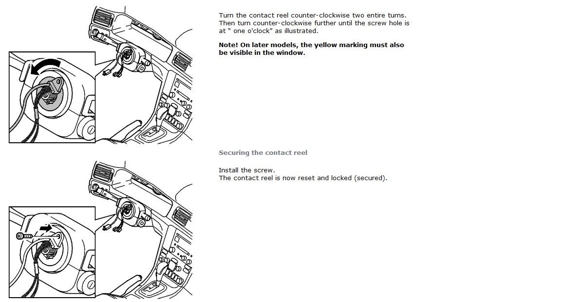

Hello, can anyone tell me if the V70 STEERING ANGLE SENSOR should turn smoothly in both directions when it is not on the vehicle? My 2006 V70 was giving a SAS error so I bought another on Ebay but when I have the original, or the 'Ebay' one in my hand neither turns smootly through 360 degrees. Also is it OK to turn the centre of these units when not on the car? Both my original and Ebay ones appear to be able to turn 6 times before fining some resistance. I see new ones have a screw to stop them turning in transit, but does this screw also show that this is the 'install position' ? It seems the unit can be fitted 360 or more degrees from this position.
Old Apr 17, 2021 | 09:13 AM
With a used part (that you have removed the screw and messed with), I would follow Volvos procedure to recenter the sensor before installation.
