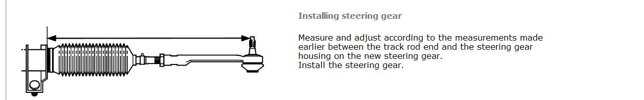

Did you verify the steering arm length was the same on the old and new rack as pictured below?

Actually no there was such a extreme difference one side was screwed out to the point it didn't seem to have a safe amount of threads so I equaled them out the best I could

Sounds like your steering angle sensor is not in the correct position - That sensor only turns so far in each direction - and can easily get broken if installed incorrectly.
I guess since you don't have measurements of tie rod length when they were on the old rack - remove the steering angle sensor - so you won't break it when turning lock to lock when you find the center point of the rack, find the center point of the steering angle sensor, install it and the steering wheel pointing straight ahead - then see if the tie rods can be adjusted to point the wheels in the correct direction.

Appreciate it I did just that and everything seems to be working thanks again
