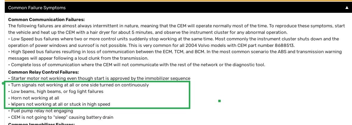

Old Mar 22, 2025 | 02:36 PM
Originally Posted by zedjr10
1. I got a 2003 XC90 with T6.
2. What are other possibilities?
1. Sorry to hear that.
2. Below is a list of common CEM symptoms courtesy of xemodex. Have you scanned all the control units with a compatible scanner? What codes do you have in the CEM?
