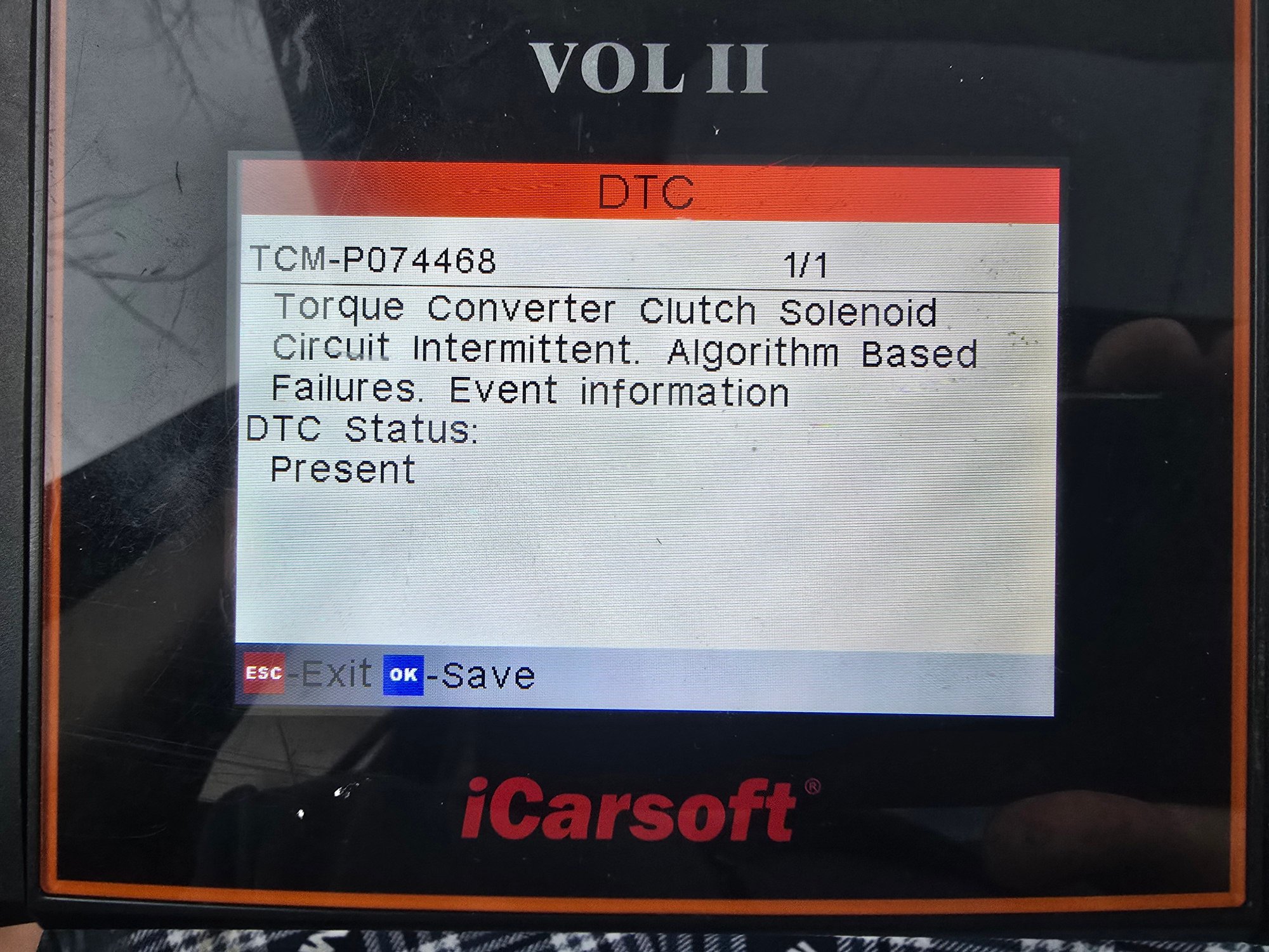

-but the kicker, its got a stutter between 1500-2000 rpm on lightish loads. Felt like a misfire but too consistent. I started thinking maybe it's a fuel trim thing from pcv leak, or a side effect of cam sensor. But it's still doing it. I haven't reset battery yet. And I noticed front a rear tires are same size and good but different brands. All searches are suggesting torque converter
(Update) I just reset the ETCS adaptive values, a quick trip around block and it's not stuttering. But it's cold, I don't think it does it until it warms up.
(update #2) not knowing what ETCS is referring to, i just decided to unplug battery for a while.
(Update #3) still shuttering, 1600-1700 only after fully warmed up. I have no service records so a fluid flush feels risky

Trading a high-mileage XC90 with known issues for another one with a mystery stutter... not the smartest move. The fact that resetting the adaptive values (whatever that is!) temporarily fixed it makes me think it's something software-related, or maybe a sensor issue beyond the cam sensor. Before you start throwing parts at it (especially a torque converter!), get a proper diagnostic scan done.
I didn't know it had the shudder until I was driving it home. I picked it up after hours during a snow storm
