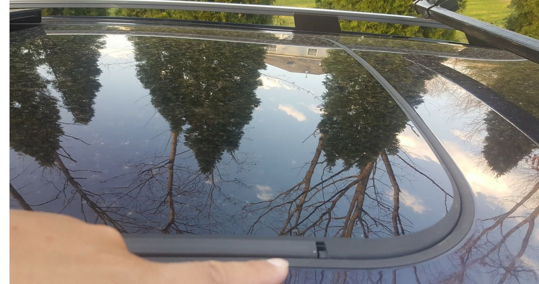

The Sunroof drain is blocked with some dirt.
How to diagnose: just spill some water in the hole at the very end of the sunroof. For me on one side water was coming out under the bumper, on the other side water started to leak in the trunk from the hole as shown in the picture.
Water coming out
What you need to do: find the pipe and clean it. Mine was on the right side:
Cleaning clog with some air
My pipe was brown color. You need to detach it from the bottom. To clean it you can use air or whatever can help you to unblock the drain. When finished spill some water and see if it's coming out at the bottom.
