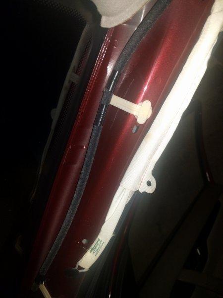

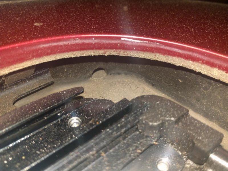

I took a look at my sunroof and it definitely looks clogged, I tried pouring water and nothing came out:
4.jpg Photo by organic_unity | Photobucket
2.jpg Photo by organic_unity | Photobucket
The left side looks much better:
5.jpg Photo by organic_unity | Photobucket

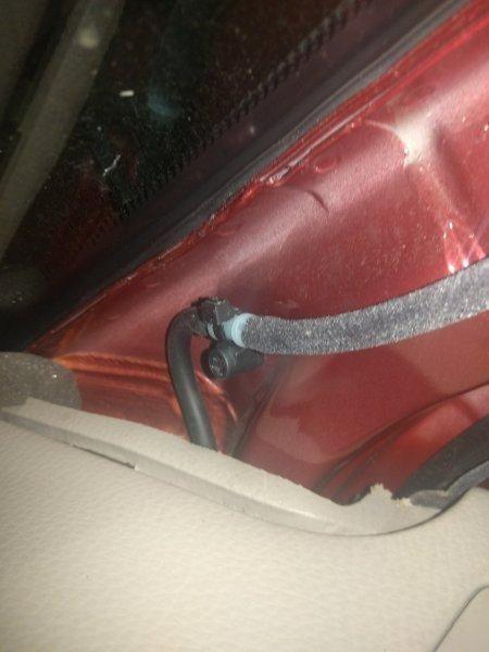

However, unlike all the videos I've been finding online, I do not have a rubber grommet to help the water exit the firewall. Even worse, the tube for the sunroof drain is not clear, so I can't see where it's clogged
11.jpg Photo by organic_unity | Photobucket
10.jpg Photo by organic_unity | Photobucket
I can't get to the exit of the tube without disassembling the entire dash, as far as I can tell. oh mannn I don't want to do that. The water does seem to be trapped in the top, for right now though.
