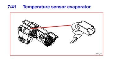

If the compressor clutch is not engaged - I've seen bad temp sensors either in the evaporator or outside air temp cause the clutch to not engage. (or the system could be simply empty) Scanning the car with a compatible scan tool and attaching a set of ac gauges would be a good first step.

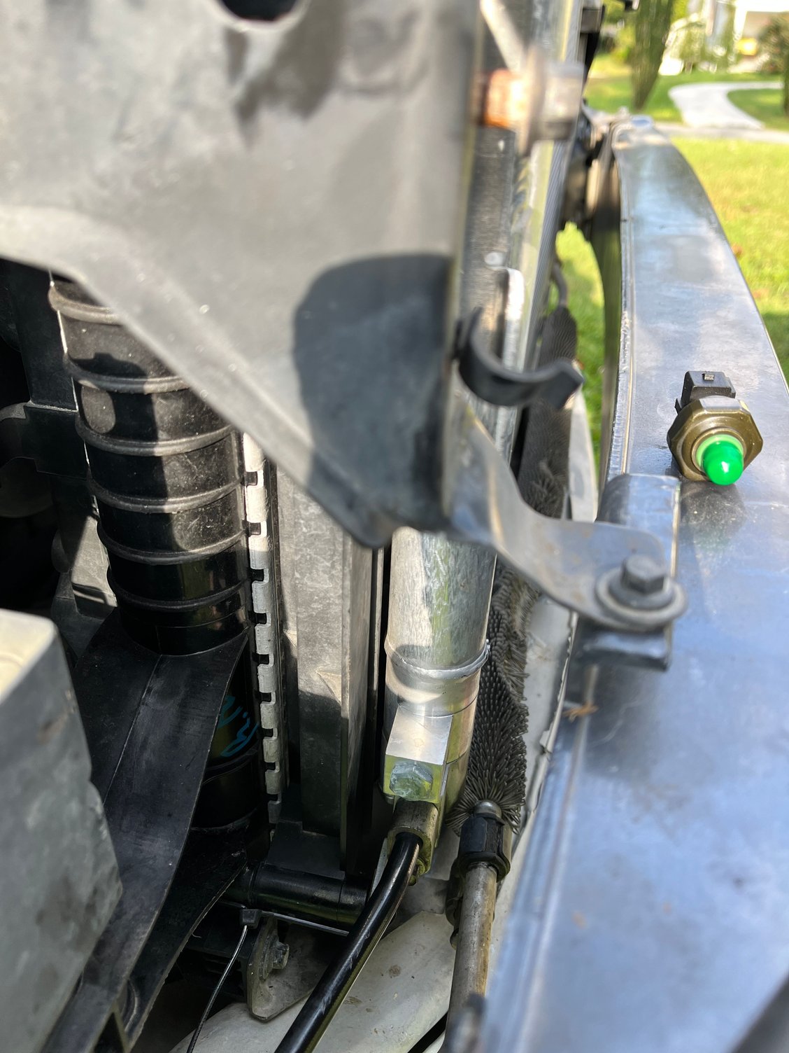

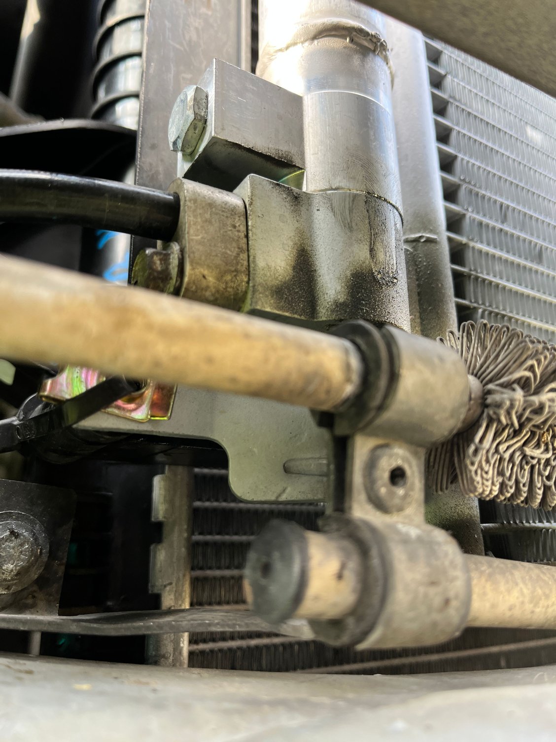

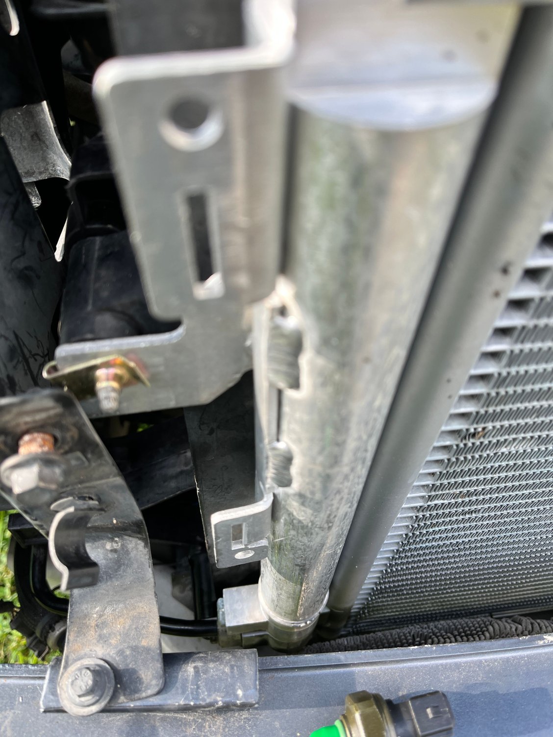

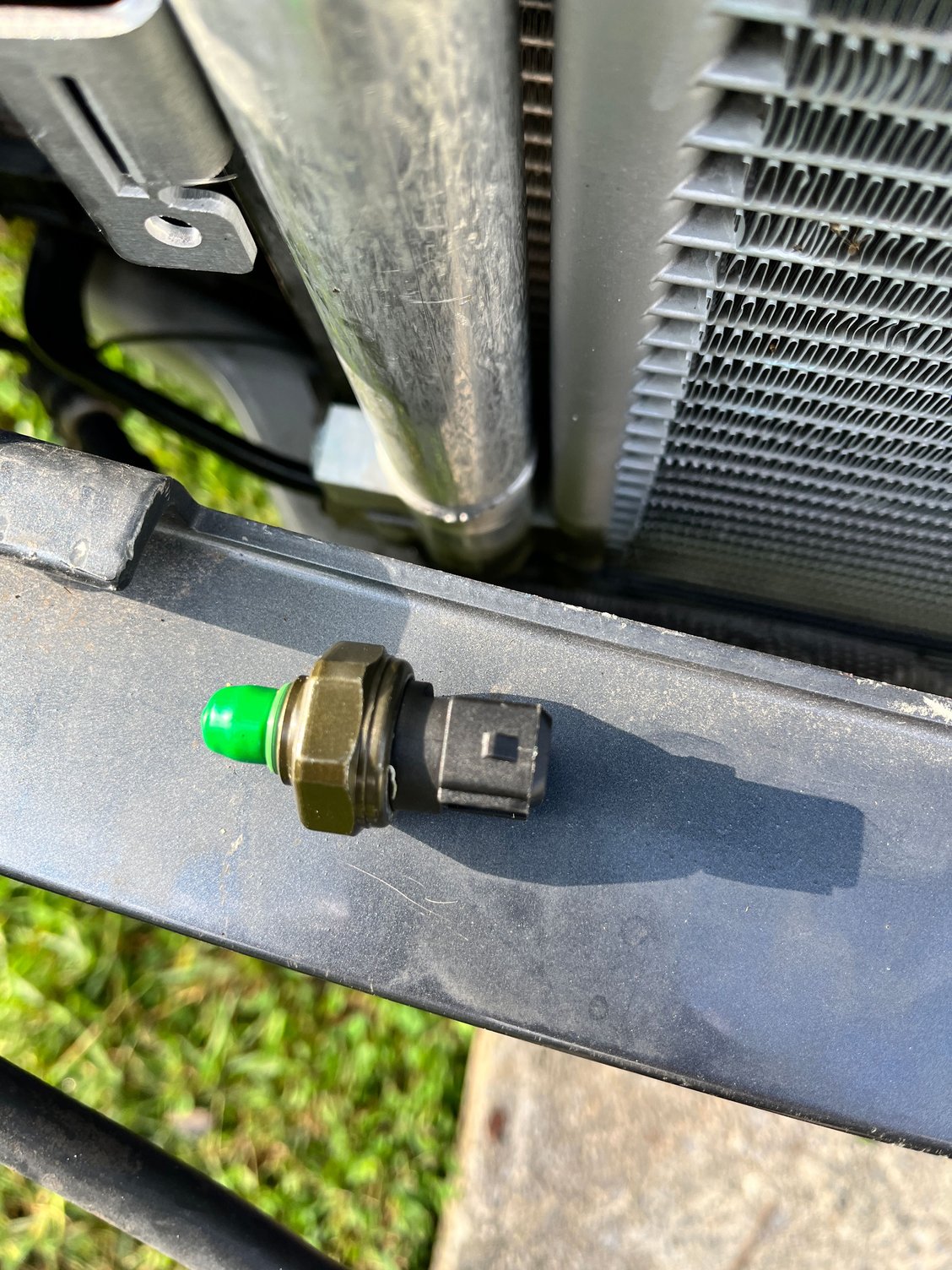

Thanks so much. Ive attached a few images of what I’m working with. Am I in the wrong area to put the pressure switch in? I can’t figure out where it goes for the life of me. 😩😩😩

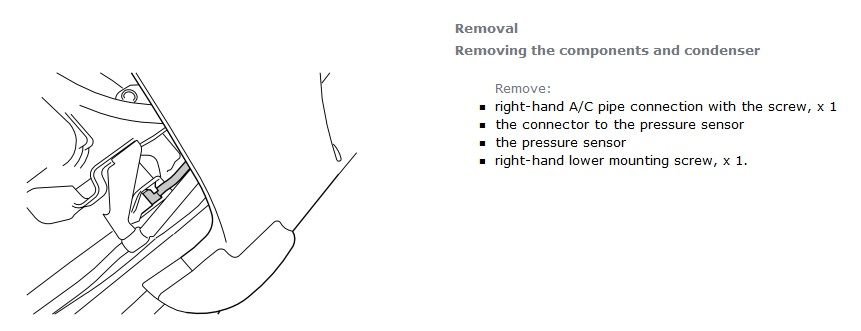

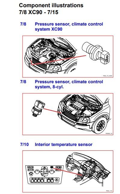

Is that a new condensor and radiator? As in a body man left the switch off and hid the wiring? Part catalog shows the switch at the bottom of the dryer, maybe where that plug is.

Yeah, that’s what I was afraid of. I’ve had such a time paying people to make my situation worse, I figured I’d do it myself. I was wondering why my setup didn’t match this diagram. I’m just going to take it to Volvo, thanks so much, you’ve been a huge help!!
