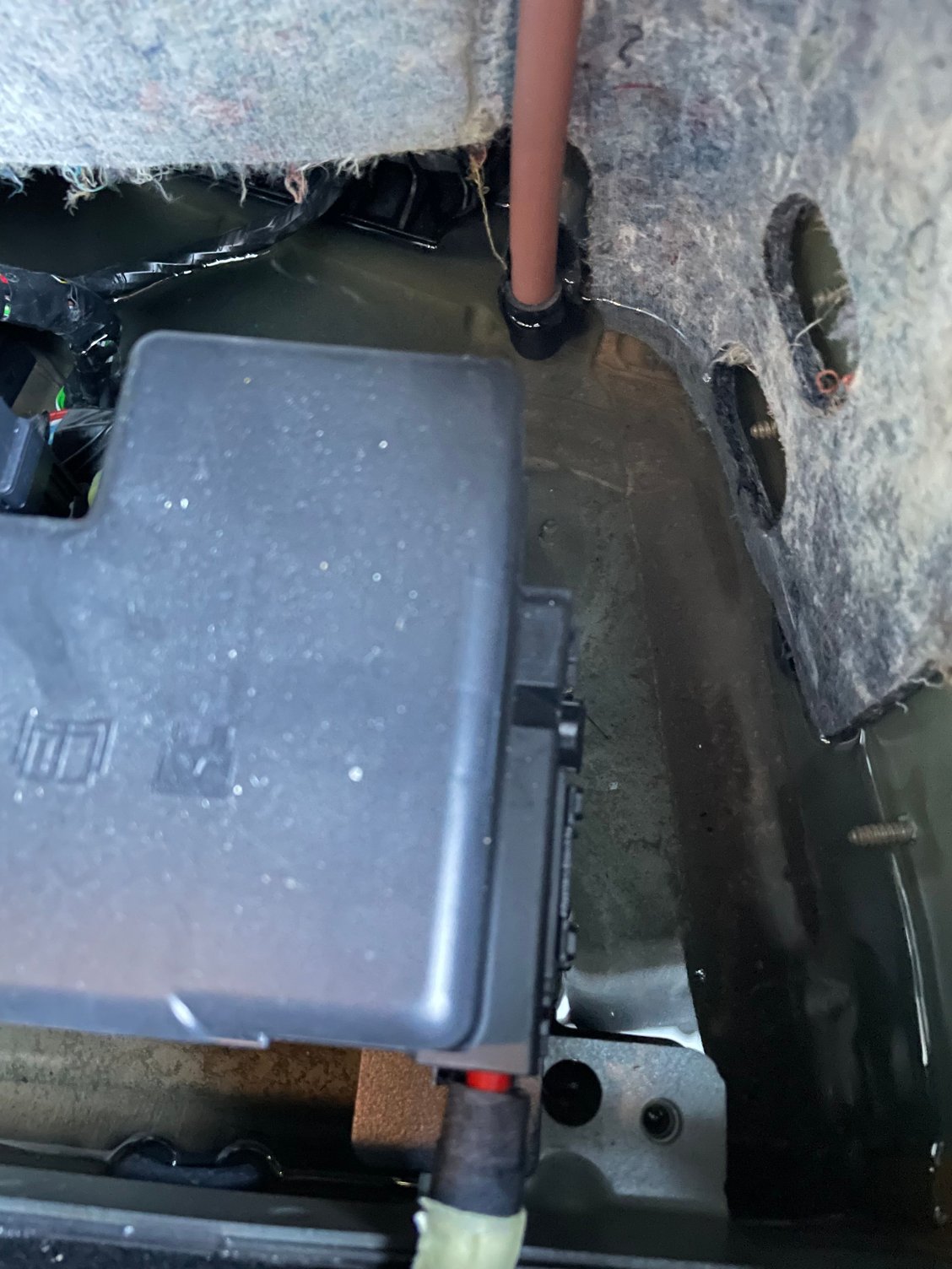

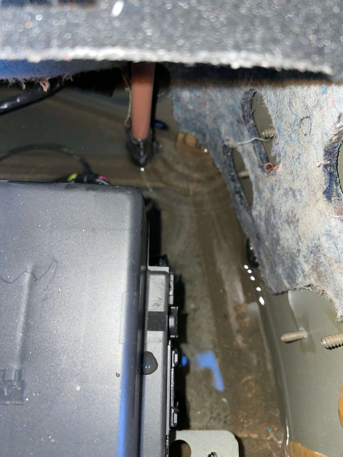

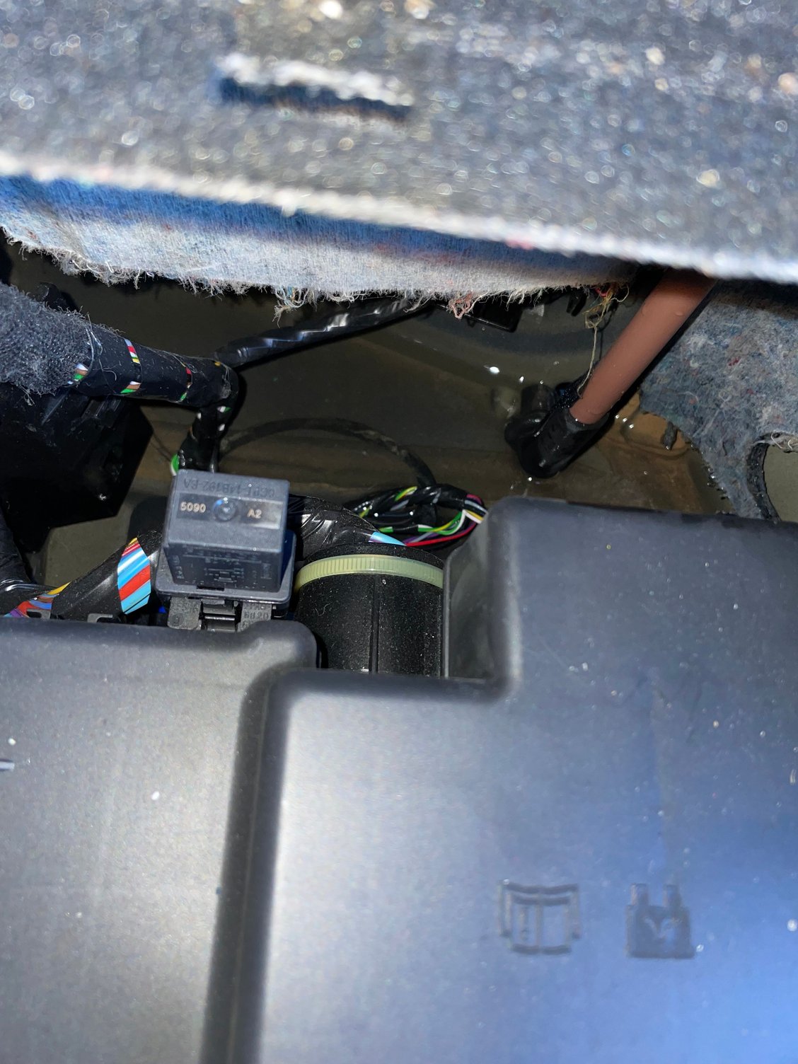

I never expected that VOLVO designers put such an important board in a place that easy to get flooded.
1. few days ago I received several system fail messages on my dashboard: NO ACTIVE STEERING, NO CRUISE CONTROL, NO GPS, NO CAMERAS, NO BLIND SPOT DETECTION
2. I checked all fuses on passenger side panel ( all ok )
3 I went to inspect fusebox at the rear end of the vehicle and It was fully flooded with rain water.
NO IDEA how water got there but very likely : COLD AND WARM temperatures FROZEN water ducts and water from melted snow on the roof flooded the space where fuse box was and VCM module mounted UNDER!!! the fuse box ! check pictures
DESIGNER of this 2016 - 2022 VOLVO XC90 should be hanged by his *****!
got quote from dealer : 2750CAD + 13% TAX and they want old module "core" for replacement fee $350
Radiciolous !!!
All rusted and water damage VCM
Visible water damage
Canadian version VCM GSM module , GPS AND OTHER DRIVER SUPPORT FUNCTIONS FROM THIS BOX
VCM PART FOR 2016 Volvo XC90
Water level
Flood
Flood

OEM part of this VCM IS : 31450885 , here is part of the email from VOLVO PARTS: "The replacement for that is part 36012656. $2768.58
This would ship from the states and take a few days to come in
There is a $360 core charge on top of this
These do not come preprogrammed. The car would need to be brought to a Volvo dealer for programming
If you’d like to order I would need prepayment for this part"
