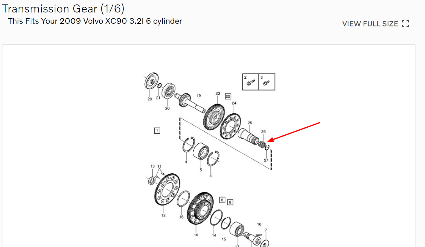

I have done some more digging and think that this bearing has gone the way of Dodo, part 26. However, there is no PN for it in the inventory, can anyone please help out with the part number and whether or not it is replaceable without taking off the main covers?

That's actually not a crankshaft pulley - but info about your problem can be found at
volvoread.com
