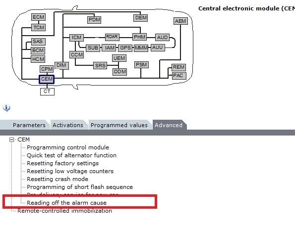

Old Apr 30, 2022 | 08:42 AM
Originally Posted by HansV
How can I find out what triggers the alarm?
Yes, Vida can "reading off the alarm cause".
