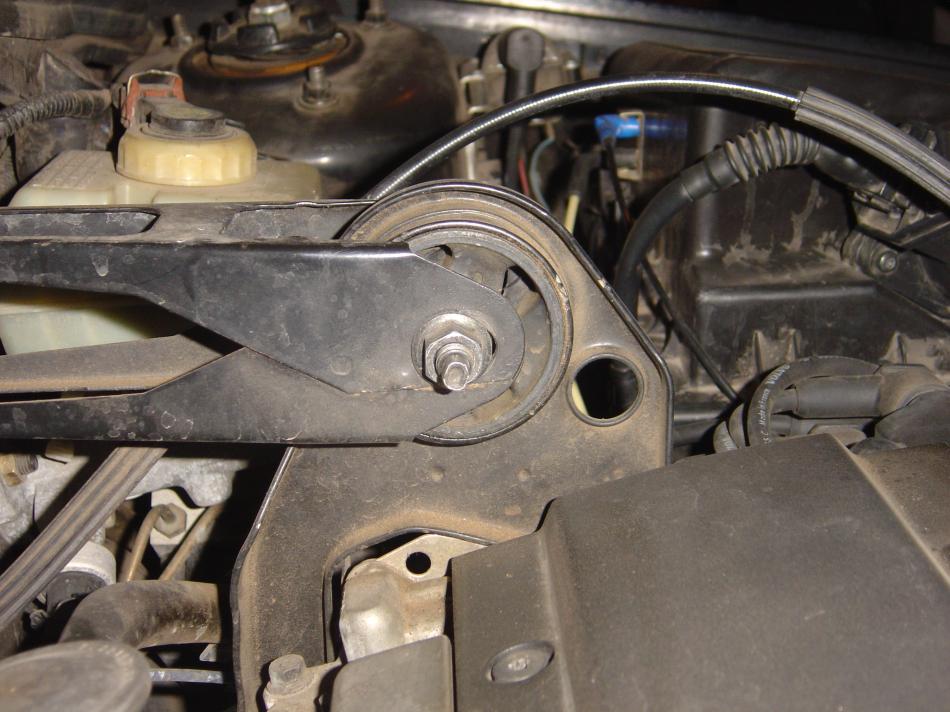

here it is
It is vetical but I instaled mine little angled.
Old Nov 3, 2009 | 08:13 PM
That mount pic looks torn.
I don't think it really matters. Once they get weak they start to tear and they need replaced. That is the most common mount but there are others that break down.
Not to mention that dirty engine bay.
It isn't torn it is just dirty. Actually there is little arrow on the side of the ribbing that show what is up.
Sorry, Gilber33, got to feed family (3 jobs). No time for cleaning.

I thought the arrow indicates up...it looks right to me. Based on what it does it is positioned correctly.
You know what PITA is to install it. I started it in vertical position but it angled itself during pushing process. Later I read somewhere that it last longer if its angeld... LOL...Good for me.....
