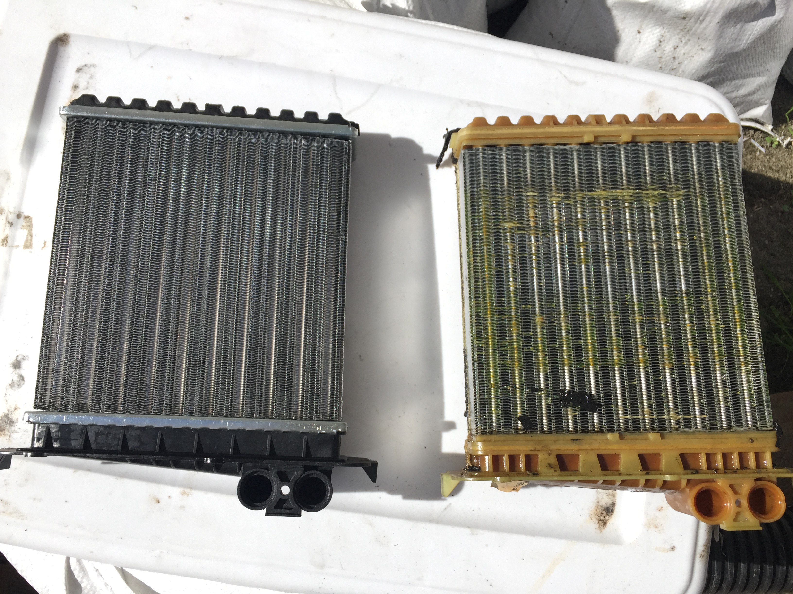

Upon further inspection i pulled back the console side trim and found that the heater core was leaking coolant (more on the passenger side) and i found several drips hanging on the corners of the plastic cover. I ordered a new heater core through Amazon for $65 with tax and that includes both oem o rings and the new foam seal strip. That should solve my smell coming through the vents, hopefully.

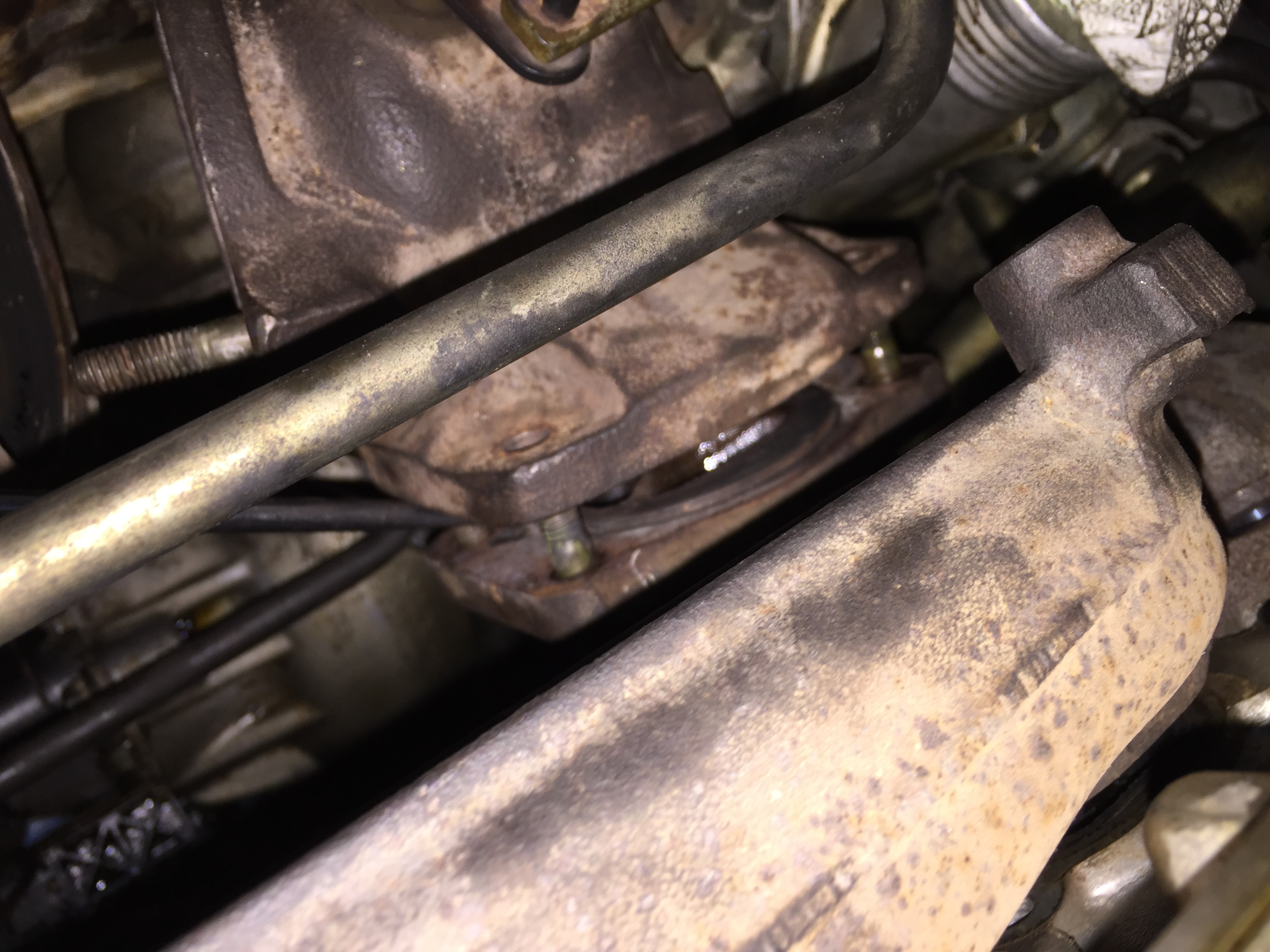

As i could not find the leak by just looking from the top or bottom with a mirror i decided to take off the manifold because it looked as if it was coming from behind it.

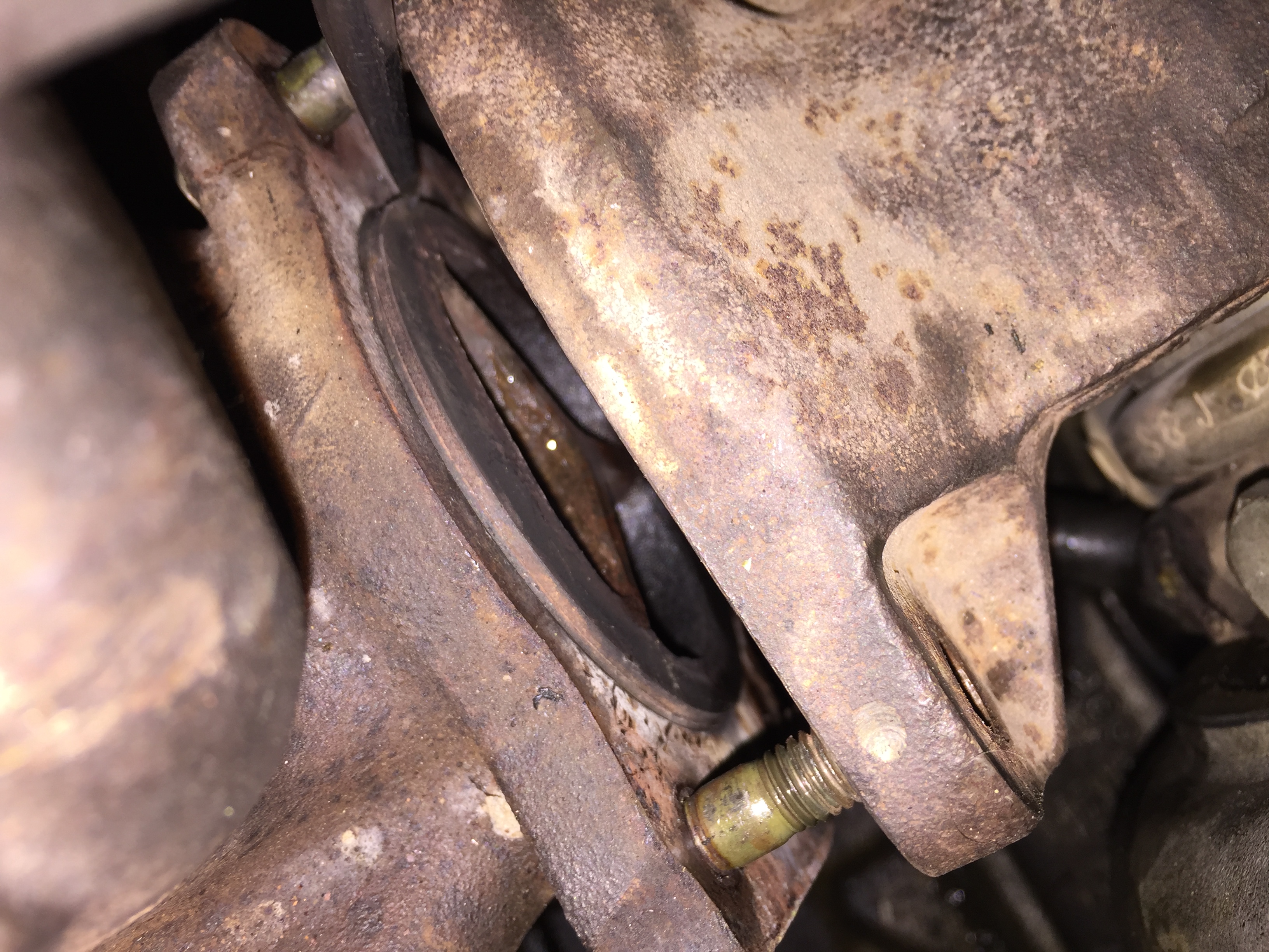

As i start to get the turbo exhaust port unbolted from the manifold flange i see some fluid. There is a chance that because there was fluid on top of the manifold that some seeped down into that top chamber. The other couple of "exhaust chambers/ports" coming out of the manifold on the bottom did not have any water fluid.
I am calling it a night because the studs holding the exhaust manifold to the turbo are being an extreme pain in the a**.
My question:
If the head gasket is bad i would see fluid coming from each of the "chambers/ports" instead of only the top?
Is there a chance that fluid would leak in through the top of the seal?
