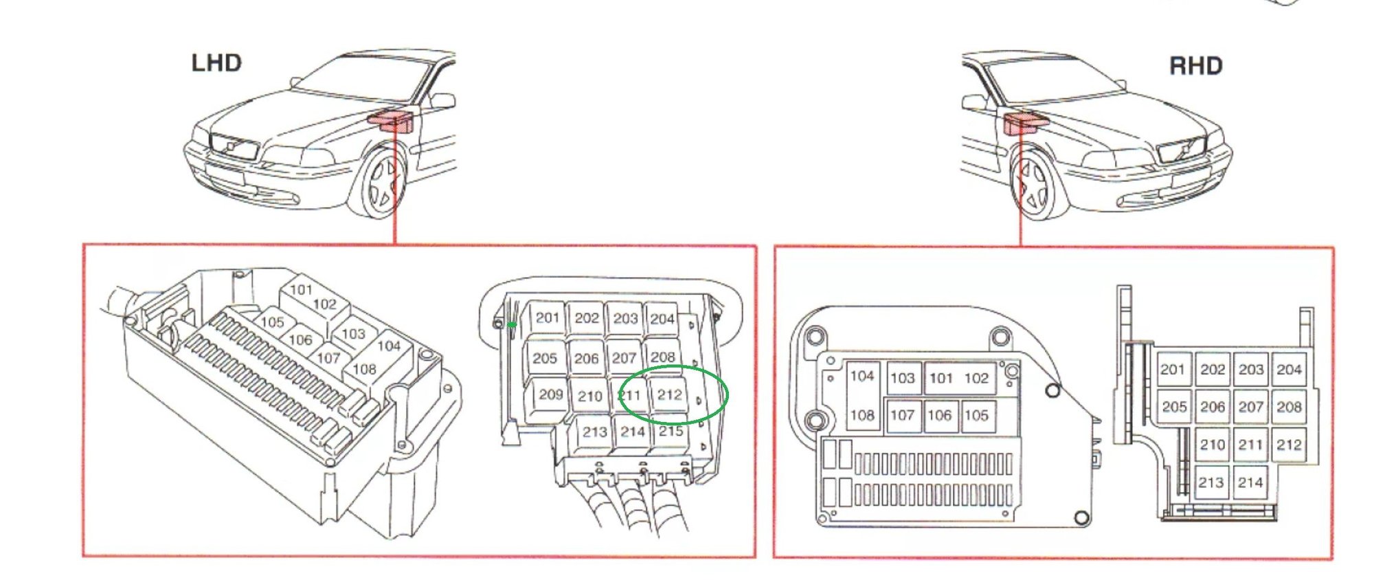

As mentioned in another thread, the dome lights aren't working and door chime won't stop when the doors are shut. Is there a way to disable the door chime?

Unplug it

Thanks hoonk. Where do I do that?

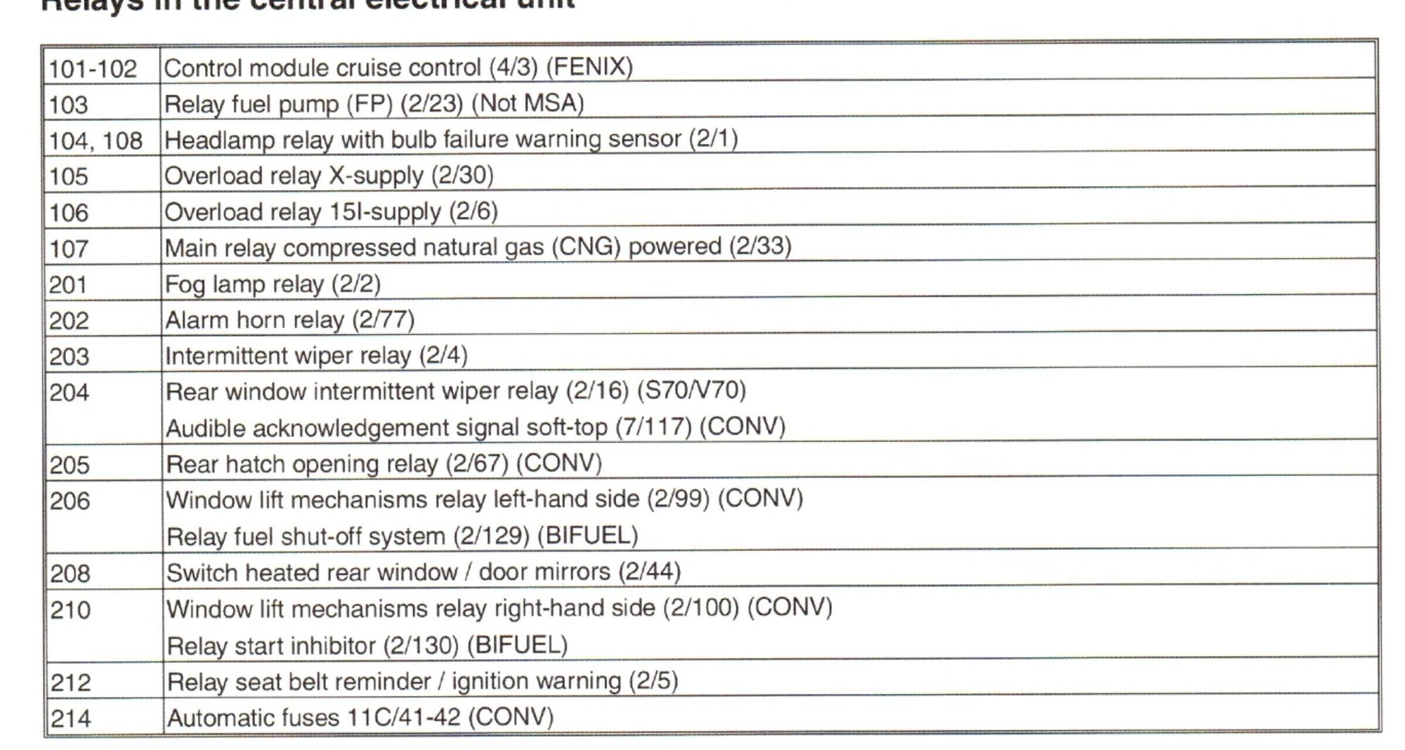

Could be relay 212
