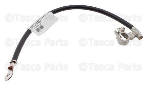

Do you guys think the most likely issue is?
A) Faulty negative battery cable?
Is this unlikely since the car has Power, Lights and even headlights work?
