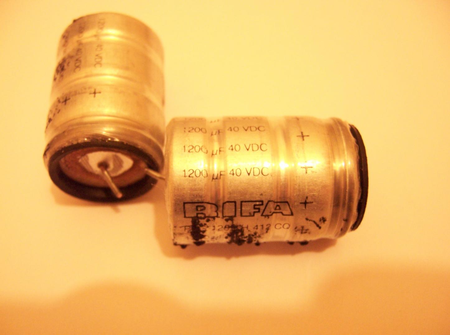

radiator fan $500. that's expensive but typical failure. You can remove the electric module that's on the fan, un-glue the cover, then replace the two capacitors inside.

Those are the bad boys that go bad. RIFA 1200mF 40V
You need to cut them from the electronic board and leave the board pins where they attach as long possible after the cut. Then use patience and a good amount of soldering paste to attach the new ones. Careful with polarities, note which way the old ones are installed.
The electronic board is inside a sealed casing. A couple of screws, but the metal plate has strong silicone along the edge, so carefully pry open step by step. Then use some silicone to glue back.
Capacitors on Ebay. Only 1000mf but plenty enough: LINK
At least on non turbo models, removing the radiator fan is tight, but definitely easy, just shake it patiently, it took me maybe 1 minute to remove it from there (once everything is detached) and same to push it back.
