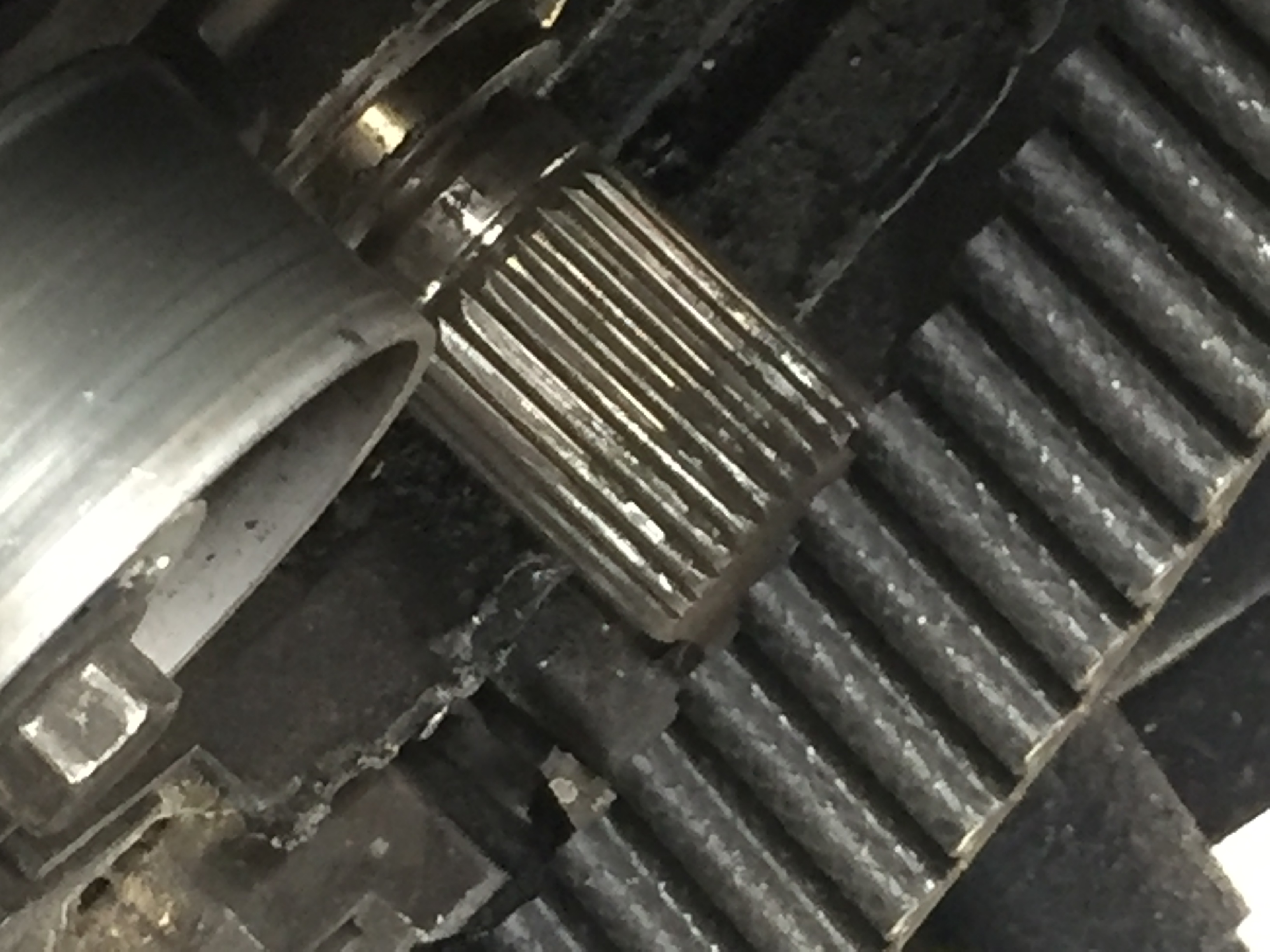

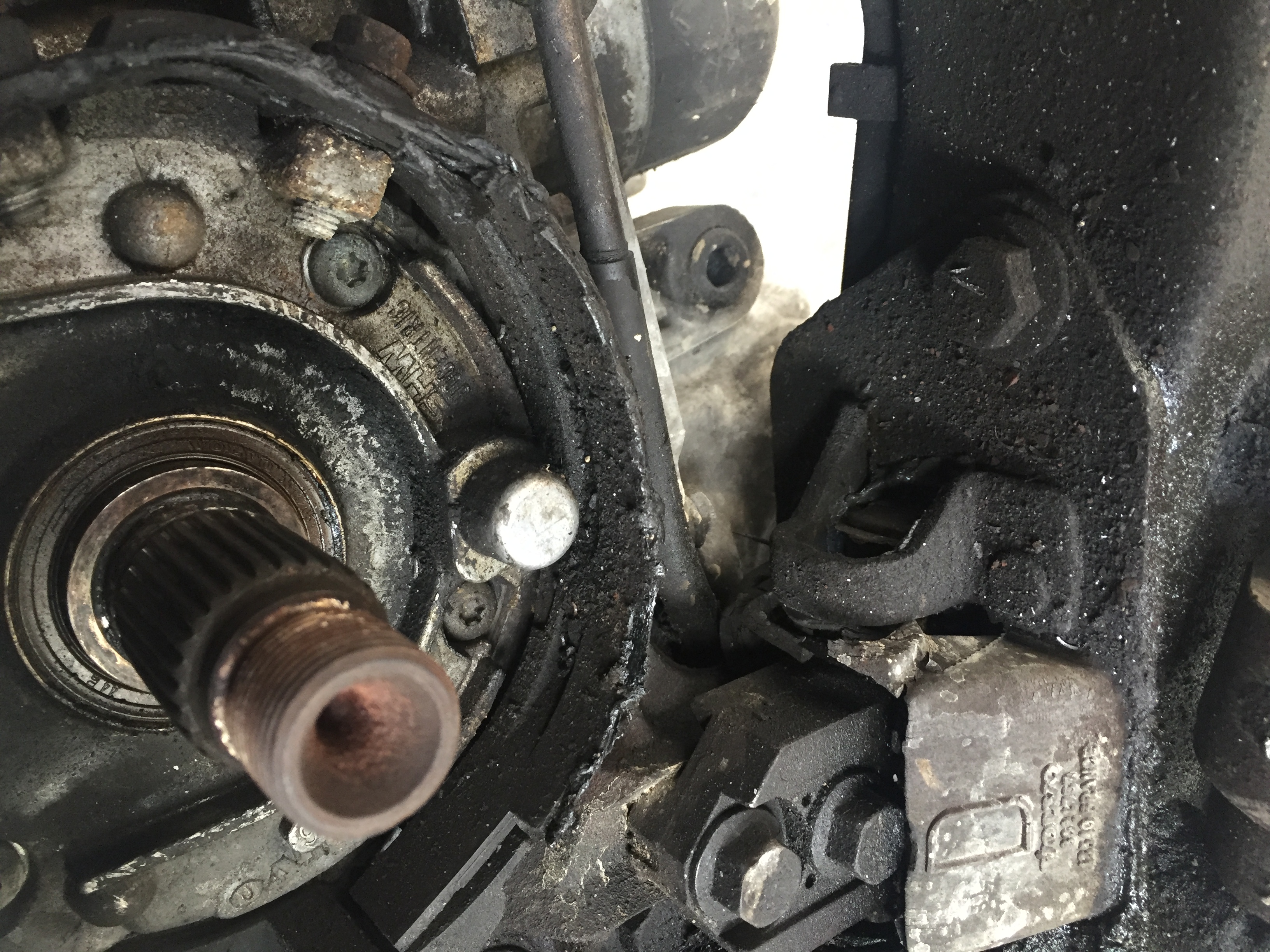

Four months and 6000 miles later the car dies on the side of the road. It was towed to another garage and told by a quick inspection there is no compression and it appears the car has jumped timing as the belt looks loose but still in place.Garage A gets the car back and looks deeper and tells me the crankshaft timing gear is stripped and caused the problem. It was determined because the gear could be turned by hand and upon removal confirmed. A scope camera confirms the valves are damaged. I have attached a picture of the inside and outside of the gear. They said they did not remove this initially and it was difficult to remove because of corrosion. They are not accepting responsibility for the toasted engine. Getting closer to my questions.

Two said they have never heard of this part failing and would not have noticed this doing the timing belt repair and the gear would not need to be removed in the process. A third garage which specializes in European imports and works on Volvos everyday said they are fixing another exact issue and said the cause of the gear getting stripped splines is because a bolt was not installed on a lock collar attaching this to the crankshaft and it would need to come off for the timing job.
Can anyone confirm if this part would need to be removed?
It seems to me if this was not removed it should have been inspected or its wear noticed during repair and replacement suggested. Is this a realistic expectation with this type of service?

That gear does not need to be removed for any of the work performed. It also presses on and is then held on with the large nut that holds the balancer in place. I've never seen one strip.
