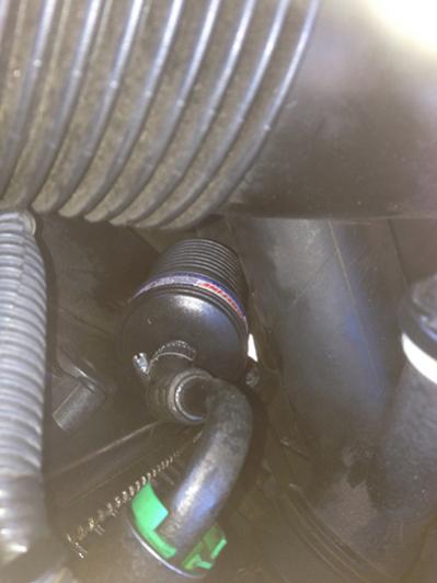

Hello joepataydis and all. I am very pleased to say my XC70 has never shifted so smooth! I started by doing a drain and fill 3 times with 300-400kms between each drain and fill. Last week I did the full Gibbons / transmission flush with Valvoline Max Life Synthetic Trans oil purchased at the local Walmart. I did contact Valvoline and they confirmed the oil is for the Volvo XC70's.
I also installed the Magfine inline filter as attached here to give me the extra protection :-)
I will post later on to keep you all informed!
