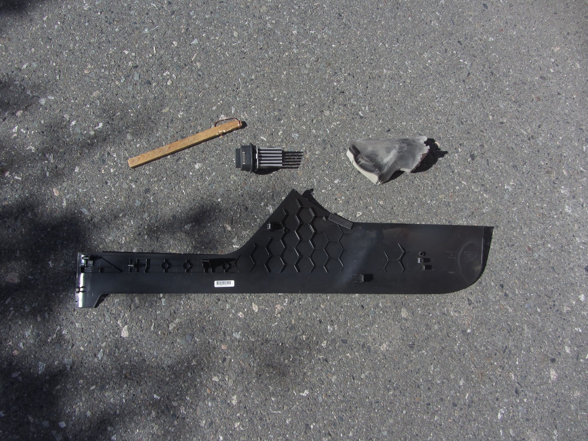

To take the resister out is quite the task in itself. Instructions call for you to remove a chunk of the sound proof material that is bonded to the firewall. The rubberized coating has even been pre-sliced to help you do this. Appalled at the suggestion of cutting into my wife’s car I tried, and failed, to bypass this step. I even fabbed up a tool to quarter turn the resister out of its seat (CCW in case you were wondering). What I found was that the resister ends up interfering with the foam on its way out. Save yourself the trouble and just cut that foam out of there.
Save yourself more trouble by plugging the connector into your replacement resister before screwing it back into the car. With the bad resister out I took a multi-meter to it and measured a dead short across pins 1 and 3, whereas the new part measured 147KOhms. With the resister plugged into the wiring harness the installation is the opposite of the removal, except you are left with a check of foam as a souvenir.
Custom tool, blower resister, chunk of foam, and panel
