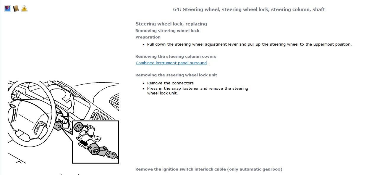

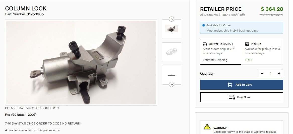

If the cylinder is damaged and won't work with the original key - Simply order a new steering column lock. Order it from a Volvo dealer using the VIN number (and probably proof of ownership) and it will come precut for your existing keys. (make sure your key works BEFORE bolting it onto the steering column)
The lock cylinder by itself is not removable. There are no electronics involved so no "programming" using VIDA is required.

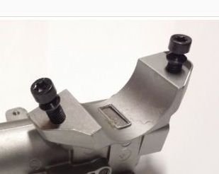

You will find no bolts heads on the two bolts shown below. They are security bolts and the heads break off when installed. I use a right angle drill to remove the heads. Some have had luck using a chisel or punch to loosen the bolts.

since it requires removing the steering wheel I need to weigh having it towed to a shop instead.
The steering wheel does not have to be removed. Simply take the plastic cover off, drill or remove the security bolts with whatever method you choose, and bolt the new steering column lock on. Takes less than an hour if you have done a few before.
