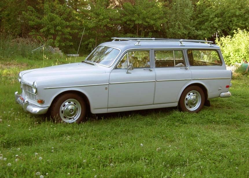

My first post here... on behalf of my sweet partner. He's had this beautiful old 68 volvo wagon (photo below) ever since we met (1990) and he is very fond of it. We have a problem with starting. History: This engine was just rebuilt. We put on a Weber carburetor as the SU's were worn out, which necessitated a change-out of the manifold. We have a new mechanical fuel pump, new filter, new gas lines from the pump to the carburetor.

Man that car is pretty, I sure wish mine looked like that!
