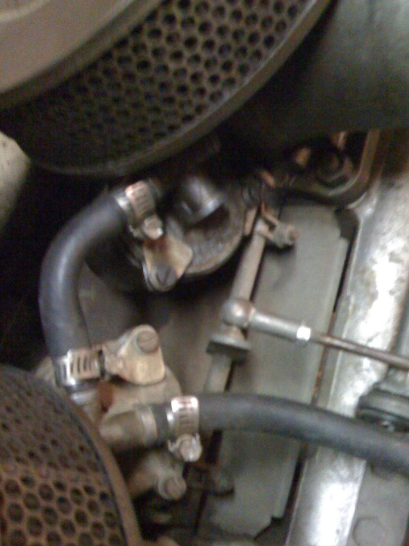

Hello everyone!
I purchased this Volvo a couple years ago and I've never really had a problem with it. Use it as a daily driver every so often. Just recently the carb reservoir has started filling up and spilling fuel. On to the exhaust I might add.
My first instinct was that there might be a clog so I took apart both reservoirs and cleaned out the sediment and made sure the lines connected to and between them were clean. Put that all back together and was still presented with the issue. Then I took the hose that connects to the bottom of the carb needles out and fuel flowed freely out of them as well. So no clog.
This first appeared about a month or two ago and then went away and I had no issues up until now where every time I start the vehicle this behavior starts about 10 seconds after the car is running. Of note, I replaced the in-line fuel filter a few months ago. I wouldn't think this would have anything to do with the issue. Maybe an increase in fuel pressure, I'm not sure.
I've attached two images of the dual carb setup and a close up of the offending reservoirs so you all know what I'm working with. I believe they are Weber carbs.
Any help is appreciated. Thanks in advance!

Have you checked your float valve or fuel pressure?
Old Apr 1, 2019 | 04:47 PM
sounds like the float valve isn't working. and the volvo EFI fuel pump has *WAY* too much pressure for a carb, but maybe it was bypassed and its running on the in-tank transfer pump only, which just generates a couple PSI, I dunno.
