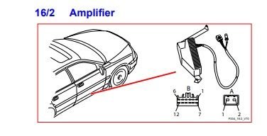

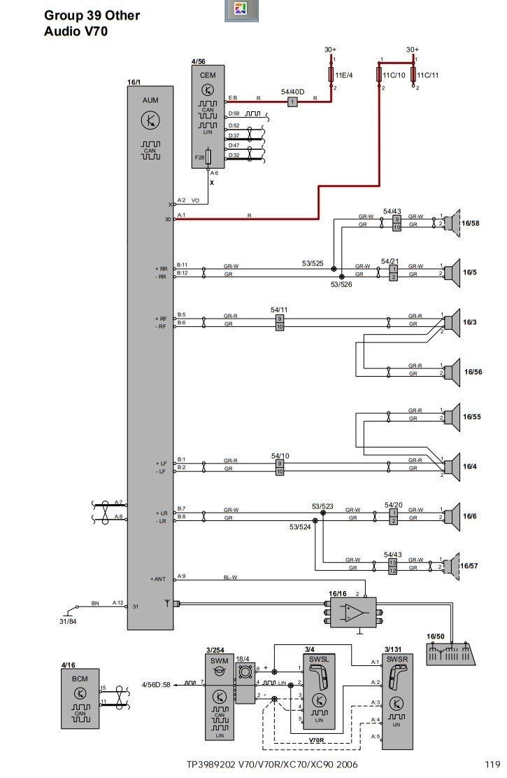

The external amp - if equipped, is mounted under the passenger seat and readily visible. The cd changer DIN was plugged on the head unit but not plugged into anything in the back of the car. The speakers if no external amp is installed are powered by the old head unit. Here's a wiring diagram - if you have all those speaker wire connected to the Head unit on the B plug- you don't have an external amp. If you have an amp the B plug/harness is pulled down the side of the console and plugged into the amp harness.

Thanks to all who posted advice. I discovered that I do not have an amp under the passenger seat. My head unit has the amp built in. After talking to Crutchfield tech I was able to splice the speaker wires on the Crutchfield harness and the new unit worked. I'm still not sure what the 8 pin DIN plug does but it does not matter now since my new unit works.
