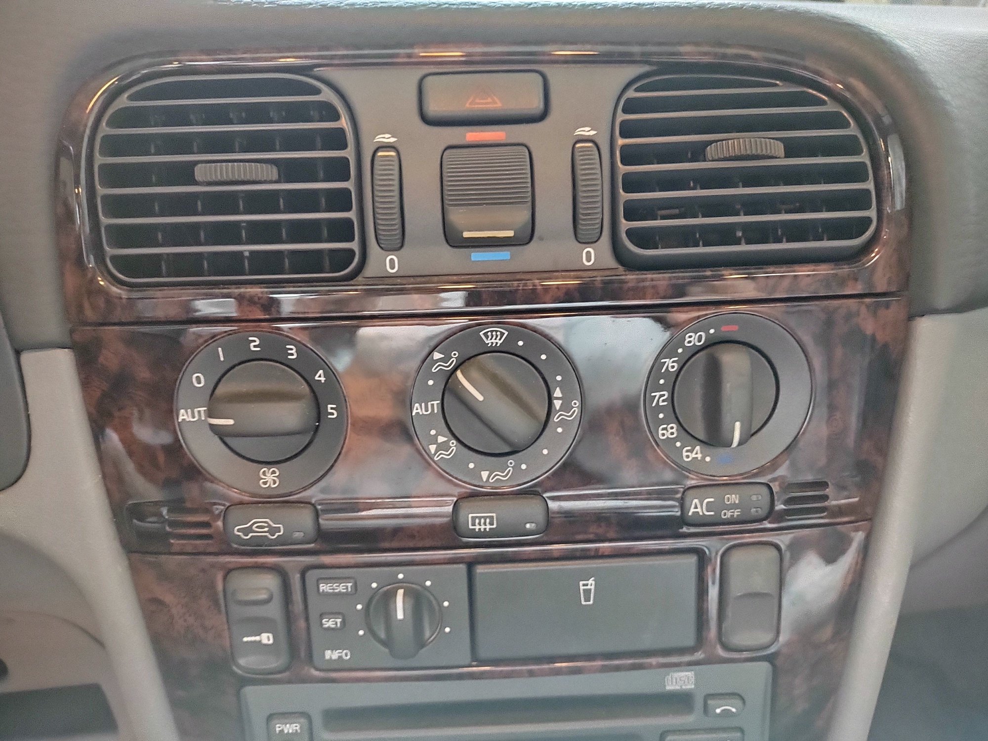

I have a couple of bad bulbs in my climate control panel in my 2000 V40, and am looking for some direction on how to remove the panel to replace the bad bulbs. I did some research online suggesting the panel can be pried off using a flat screwdriver, but when I tried that method, it felt like the faux wood plastic might break.
Any direction on how to proceed would be appreciated. I attached a picture of my specific panel for your consideration. The panel I would like to remove is the center panel with the three dials and 3 buttons below the dials.

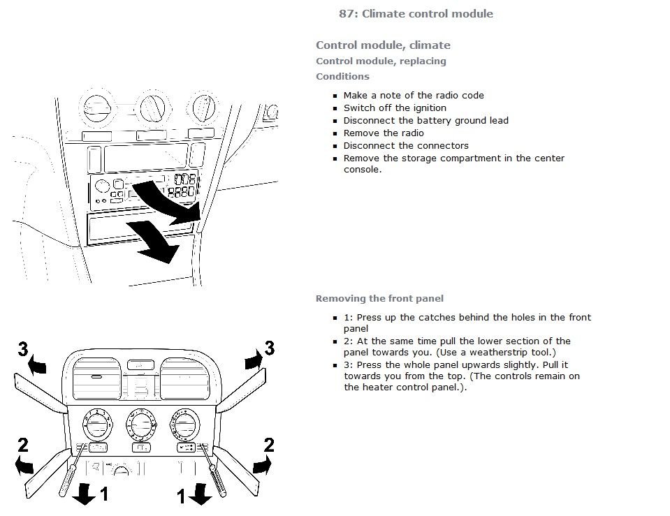

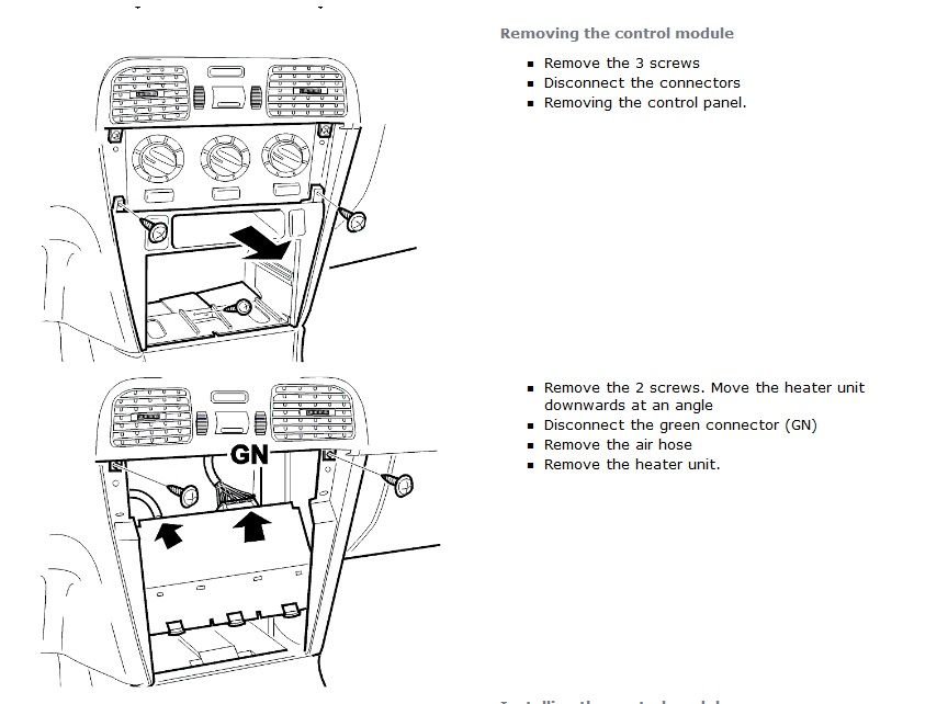

Here's what Volvo says to do.

Perfect! Exactly what I was looking for. Thanks man!

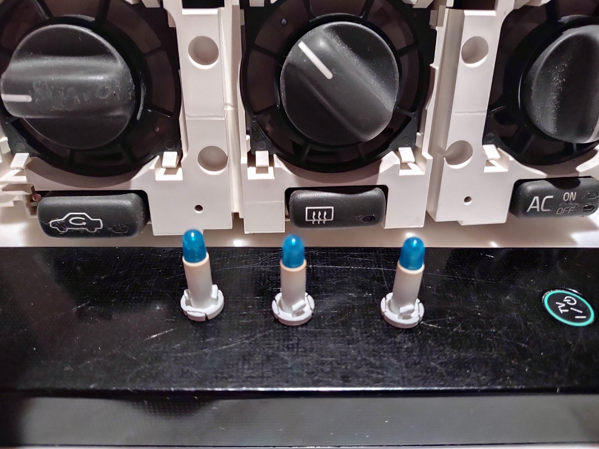

Thanks to your help I was able to pull my climate control panel Hoonk. Two of the three bulbs are bad (see pic). Would you suggest I purchase replacements at the dealer? I don't mind spending a few extra bucks - I just want quality bulbs that will last.
Thanks for all the help!

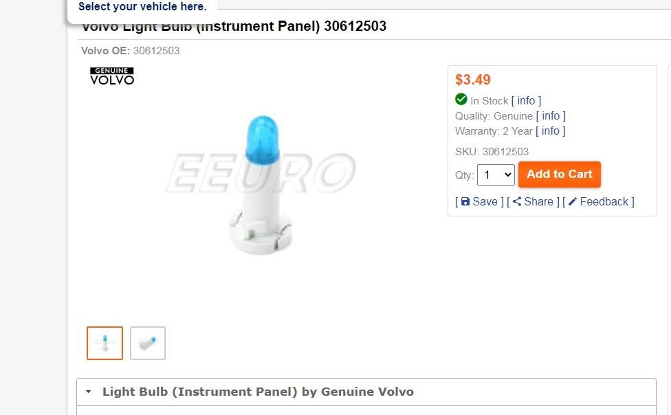

Old Jan 2, 2022 | 08:27 PM
These?

Sure looks like 'em Hoonk. Genuine Volvo OEM too, huh? Would you buy 'em from these folks? Who's the supplier?
Thanks for your help man!
Old Jan 2, 2022 | 10:26 PM
Bradrhoads's Avatar
Joined: Dec 2021
Posts: 39
EEURO. Got it - I see it now. Thanks man!

Success! Thanks everyone. Thanks Hoonk - those diagrams were invaluable!
