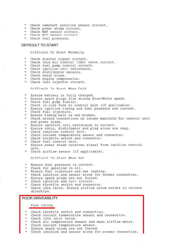

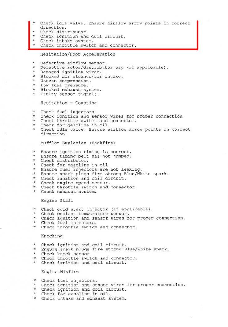

Whenever you service your Volvo, make sure you're willing to pay a bit of extra cost for OEM parts. OEM-Original Equipment Manufacturer; companies that supplied parts for Volvo's assembly plant.
If you haven't yet had the recalls done, you need to do that.
I'll attach a quote from Volvo's factory manual. It's from 850's manual, but some items apply to C70 as well.
JPN
Attached Thumbnails Completely and utterly LOST!!!! I pray someone can help.-850-na-driveability-2-.jpg   Completely and utterly LOST!!!! I pray someone can help.-850-na-driveability-3-.jpg
