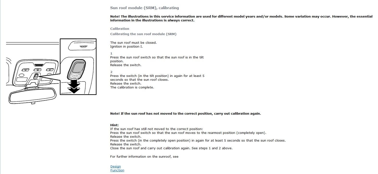

Once you get the cables even so the roof is being pulled "straight" (instead of a tooth or so out on one side) Then you calibrate the sunroof module
