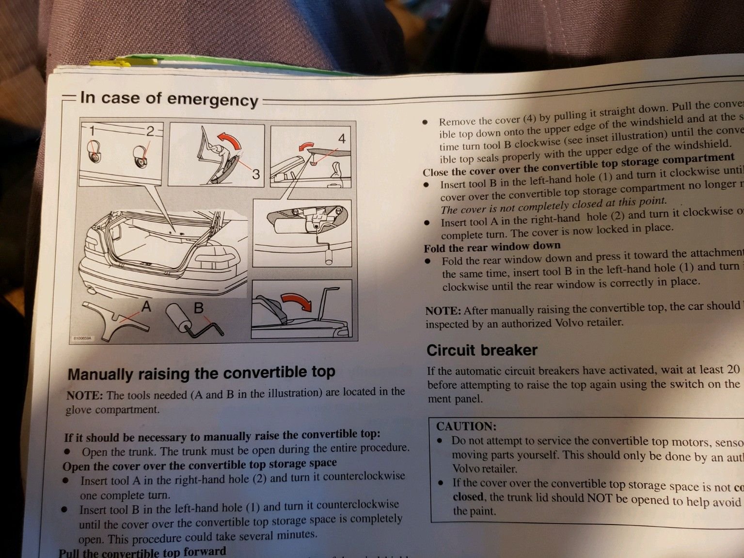

Default Part no 6817874 Tool A Combination key for convertible top
This is Tool A (6817874) that you use with tool B (8618276) to manually crank the convertible top open and close. I don't know if it is used for anything else.
This is from the manual of a 2001 Volvo C70 Covertible.
